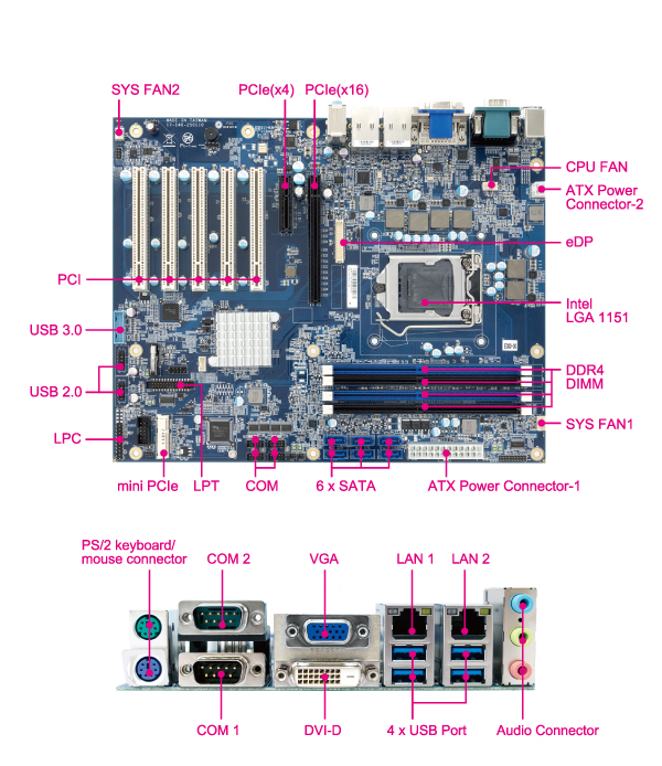

H310 Chips are already discontinued, but the new Q370 is a full featured Chipset.
You can use 8th Gen. CPUs like the i3 8350k, or i7 8700k.
This board looks like a big ass server quality board.
With 5 x PCI 32bit Slots.
http://www.protech-usa.net/new_web/Prod ... _id=%20620

Re: 2 x Asus boards 3 X PCI slots
Here’s another triple PCI 32bit board.
https://videocardz.com/75143/first-q370 ... ds-spotted
Notice the perpendicular DIMMs for Rack Mount front to back cooling.
IBase Q370 looks sweet.
I’m definately building an XITE-1/Supermicro Q370 w/ the i3 8350k CPU.
