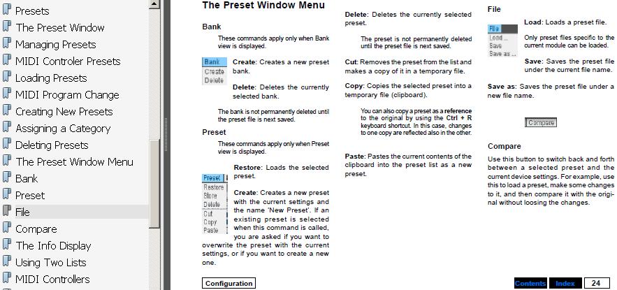

Hello Scopers,
I still can't figure out how to install the 5000 presets. I did what it's supposed to be done for that.
Didier

Re: Styledriver 5000+ Library
1. presetfile.zip > unzip "presetfile.pre" to your location
2. open device in scope > open device presetlist > menu "File" load > route to your location > open presetfile.pre
save as device default presetlist:
1. backup your scope/presets presetfiles and see what the name of presetfile is (example MINIMAX.pre)
2. save presetlist with device-auto-name (do not rename, or overwrite the "old" file MINIMAX.pre) to scope/presets location
3. next device start will load your updated presets "MINIMAX.pre" as default
download and read chapter/Configuration.pdf > from page 20
you find everything

- scope_v5_manual_deutsch.zip
- scope_v5_manual_english.zip
- chapter/configuration/page20/presets
- scope-config-pre.jpg (79.08 KiB) Viewed 5430 times
