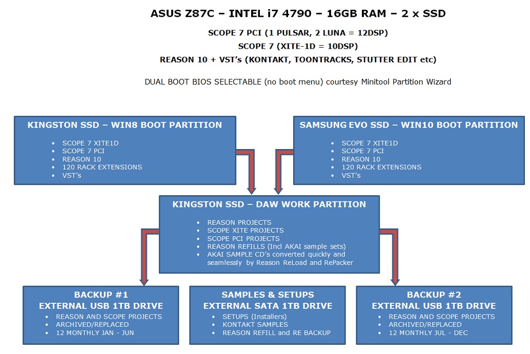

Posts: 5055
Re: Partition my HDD?
MiniTool Partition Wizard got me out of a world of pain setting up the setup below. Its aware of the differences between boot mechanisms on SSD vs HDD. You cant deal with an SSD the same as a HDD and Windows drive manager wont handle SSD
https://www.partitionwizard.com/partiti ... gKot_D_BwE
dual-boot
dual-boot
Hypersonix
Posts: 53
Joined: Tue Apr 01, 2008 6:58 am
Post by Hypersonix »
Thank you for this, Dante. Really helpful info.
