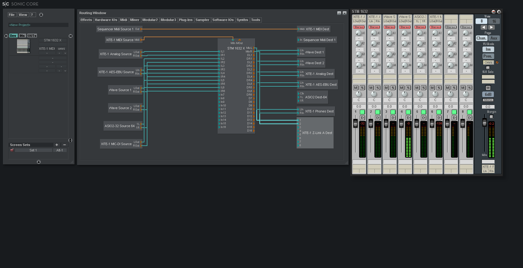

The project is just the default from install (a clean install on a fresh win7). All I added was z-link and phones out, connected to the main outut from the mixer. Before I go fetch a screenshot:

Re: No sound
Here's a screenshot.
The meter showing sound is from a browser (youtube).
While taking the shot, I had a mic on the 1. mic input (stating profoundly my frustrastion including several profanities to the World) so that should have shown in the meter in the mixer
There's no sound from the outputs of the XITE, but the A16 connected via Z-link Works as intended.
