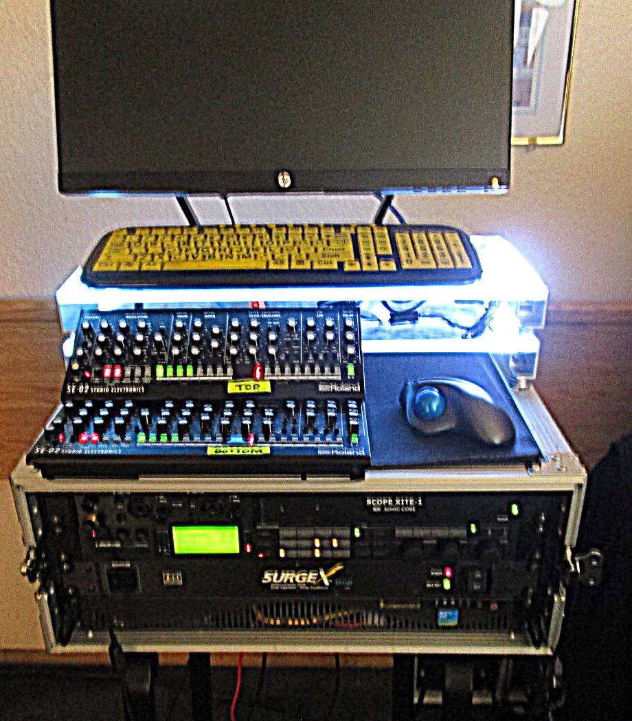

I use this now.
Dual SE-1s took up 8U in an ATA.
Heavy ass shit to lug around, but they sounded like Thor.
Now I use 2 x SE-02s with 2 of those iLok/USB/Monitor Stands.
Making presets I stack them close by.
Then when gigging I slide them in their Hangers.
I’m too burned out-to Be lugging a PA and rig to gigs.
Just show up and play for me now.
