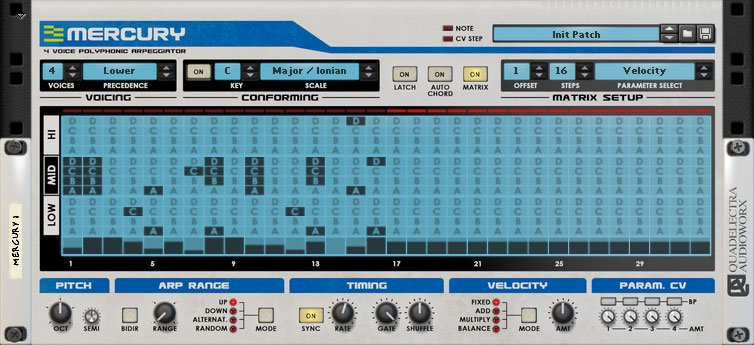

I got this one called 'Mercury' for Reason as part of a bundle deal - but havent used it yet. Looks cool :-
Mercury
Mercury
https://shop.propellerheads.se/product/ ... peggiator/
