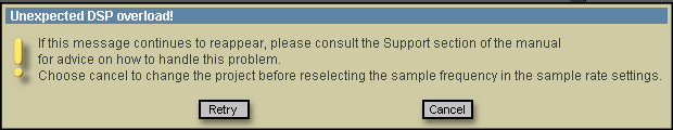

Hi,
everytime i start scope software 5.1.2709-x64 with my project, i get a Unexpected DSP overload message.
I use Win 7 Ultimate SP1.
I can not set the sampler rate to 44.1
Many thanks
Re: Unexpected DSP overload
that is likely a motherboard issue.
what motherboard are you using?
if you don't know which motherboard, is there a make and model of the computer?

Gigabyte G41MT-D3V
I moved the card inside the pci slot back-and forwards a bit.
Now it`s ok. It works.
