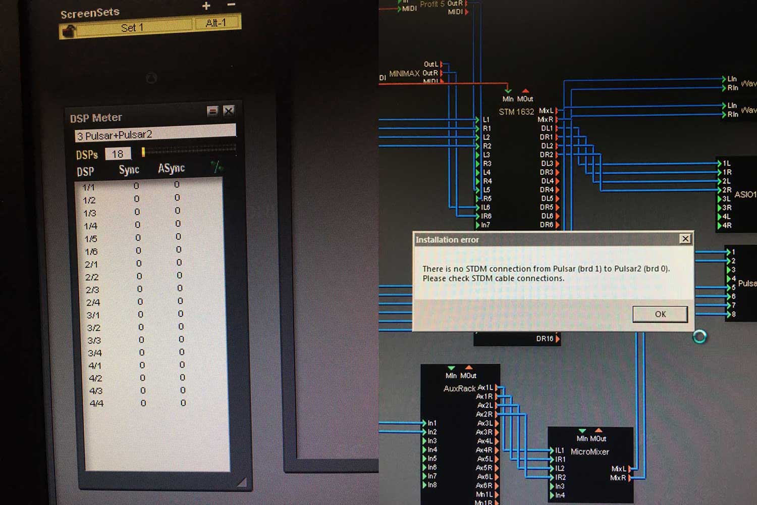

Re: Would it be possible to cascade 4 cards in one pc?
Post by subimage »
4 cards doesn't work here.
I have 1x Pulsar 2, 3x Pulsar, 1x PowerSampler. Any of them in a configuration of 3 work properly, but as soon as I add the 4th card I get these errors...
"There is no STDM connection from Pulsar (brd 1) to Pulsar 2 (brd 0). Please check STDM cable connections."
I tried 3 different STDM cables (2 made by me, one provided when I purchased another set of cards). They all work with 3 cards, but adding the 4th blows up.
