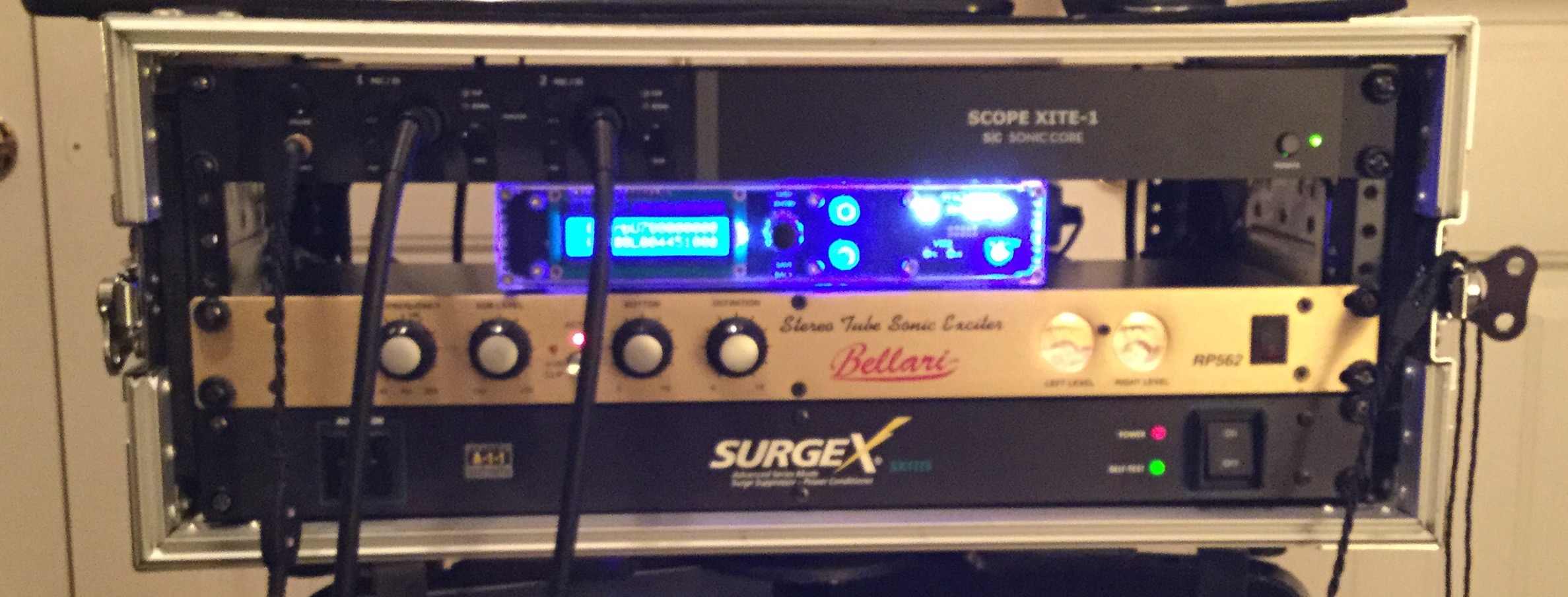

- Posts: 14368
- Location: PROJECT WINDOW
Re: planning new scope system for Live usage
4 space cases are better as the psu and fans from atx towers fit easy and are cheaper more available.
I have towers and 4U.
Hope you get things working.
Scopes mixers and effects are so easy to use live and sound even better with external hardware.
