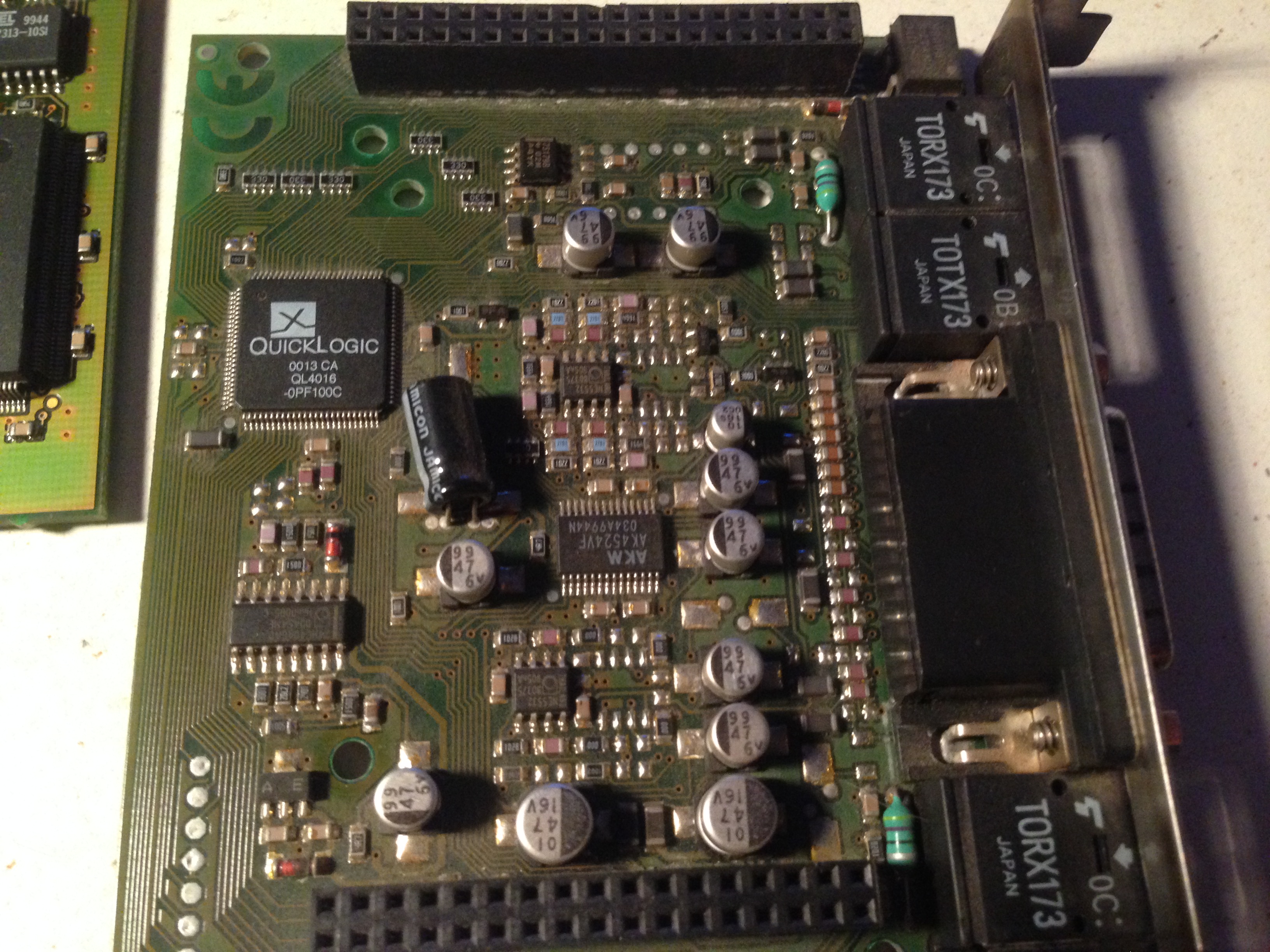

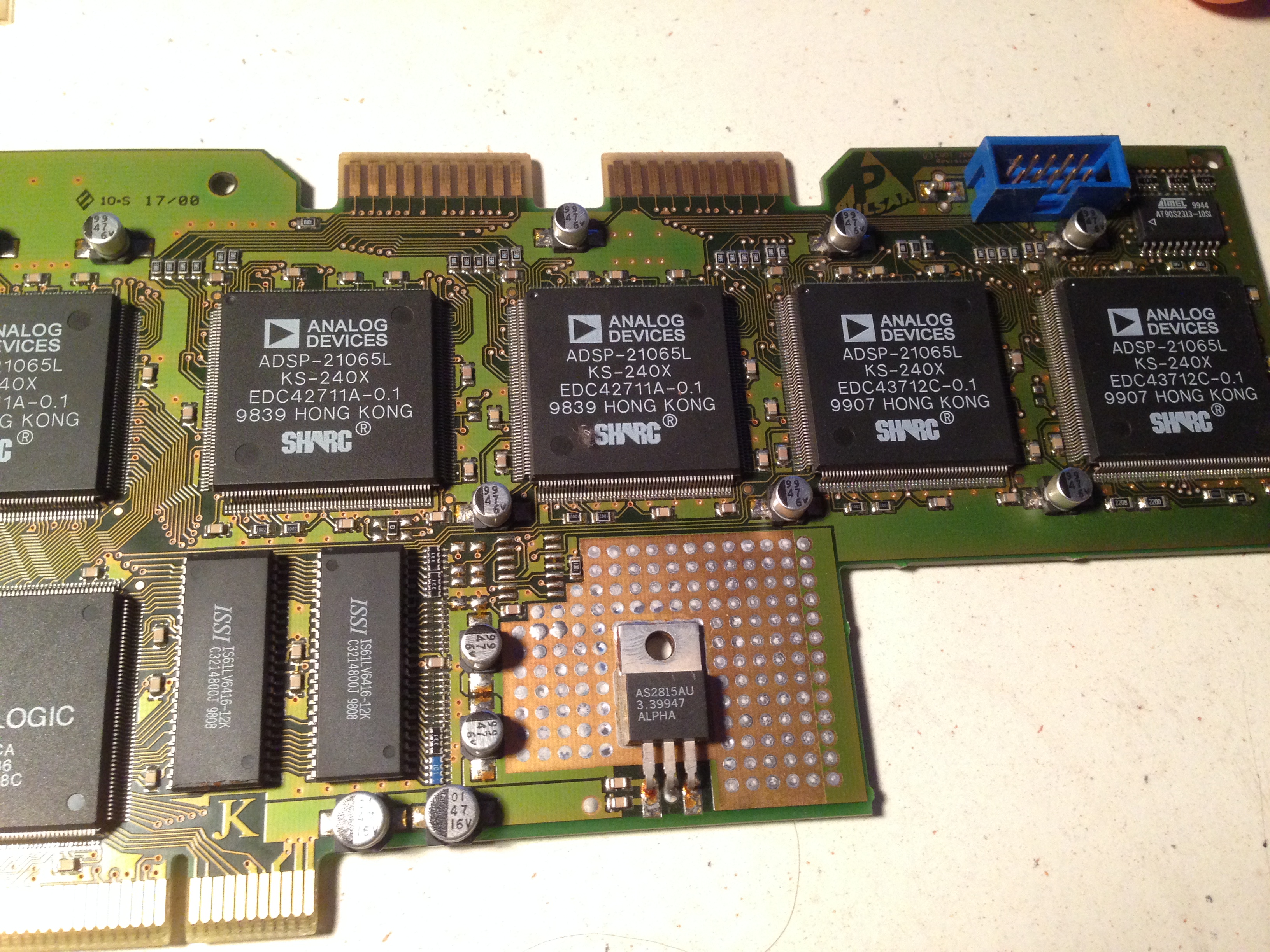

Heres pics of the card ( i took the i/o off to check caps underneath)
No obvious explosions or anything which looks out of the ordinary...
No messing around with system prior to failure. It just started to generate DSP / connection errors BUT with some jiggery pokery I could always get Scope to load.
Now however, no loading of scope possible and just the errors posted earlier.

Re: Help ! Has my old faithful Pulsar 2 finally died ?
ps - thanks, RA, I just saw your edits. nice plugins, btw !!
i seem to remember jhulk does repairs?
i will investigate further but starting to think it has to be the card now.

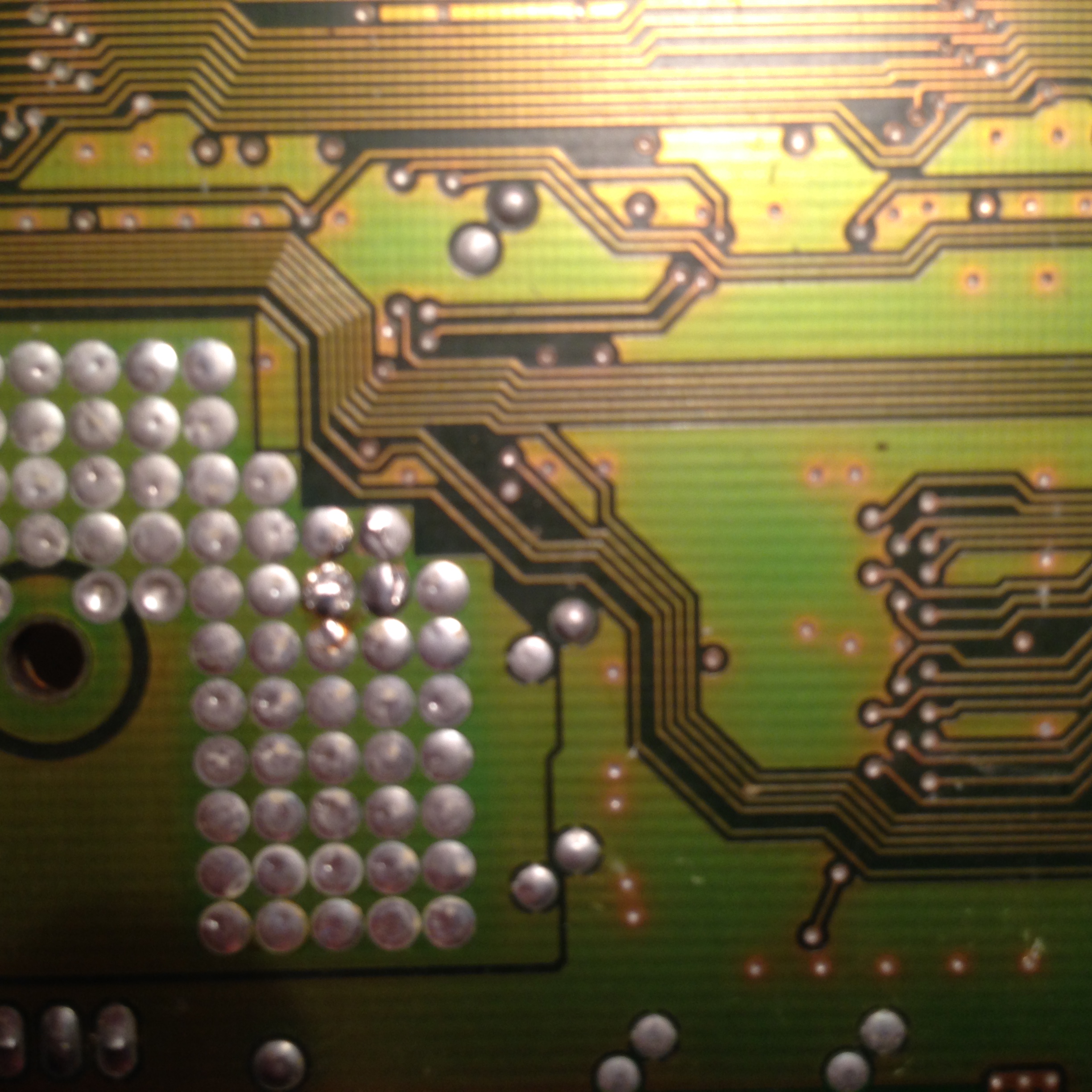

uh oh......
some of those solders looking nasty...
- IMG_5926.JPG (2 MiB) Viewed 7243 times
that doesnt have to mean anything, but the residu from the solderstuff...the brown stuff can be removed with a cottonswab dipped in some aceton.
try it on a corner first, but that's what i use a lot for removing that stuff....but again, it doesnt have to mean anything, but can always try...
just gave it a clean with 99% isopropyl.
the solder in the middle looks like it has spread and is now in contact with surrounding solders..
have followed your advice and sent a pm to jhulk and dante.
keep you posted and thanks so much for your help !
- IMG_5927.JPG (1.26 MiB) Viewed 7235 times
the solder looks normal.
I noticed there is a cracked chip. Perhaps it got knocked when you were switching things around inside your motherboard?
I do not have any idea whether this would cause a problem or how to fix it.
