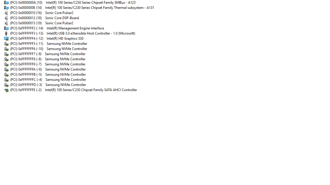

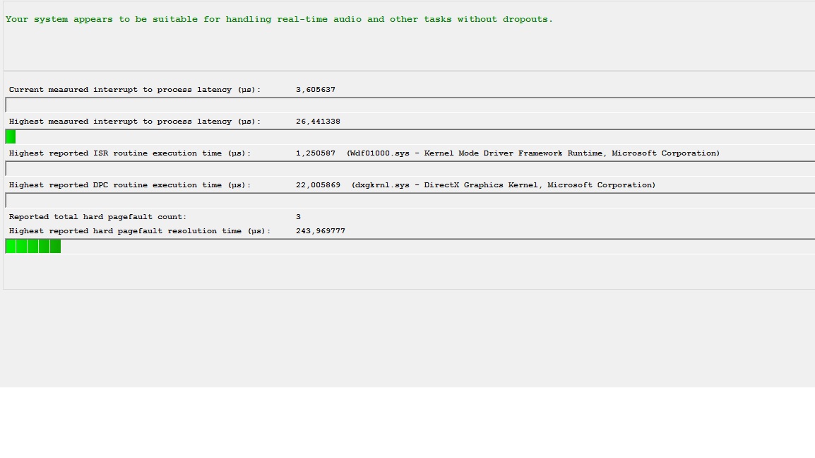

Latencymon shows low values and no problems there.
IRQ's are fine.
All i can think is :
-integrated graphic (intel i7)
-page file ? i have 16gb fast ram
-m.2 ssd on motherboard with windows 10 64bit installed
