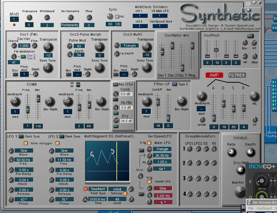

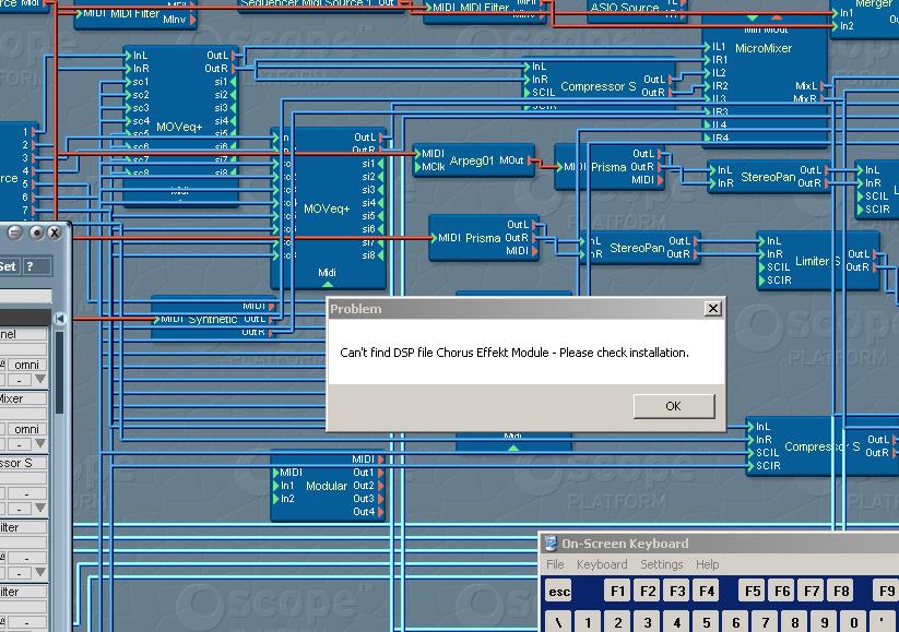

i download the synthetic synth , but he needs the dsp file ? (scopr v4.5)
where i can find it ?
Re: DSP file chorus effekt module
What is the synthetic synth ? Who developed it ?
And if you had the dsp file name, it would be much easier to help you --> The name is shown when you try to load the synth in the missing dsp file message.

I've got 2 synthetic synth, part of Spacef BBII but they don't need any chorus effekt... It's weird because I can load the "SYNTHETIC_R5Coorrected" you mentionned without any missing dsp !
Which Scope version are you using ? According to your images, it's an old one...
look in the Scope\app\dsp folder for the file.
if it's there, right click and choose properties. uncheck "read only" if there's a check in the box...

looks like a version of Synthetic that's adapted to Scope 5.1 environment (guessing from it's name)
the chorus module in the lower right may use the standard effect
this will of course be missing in an earlier release of Scope
originally (in this position) there was a slot to choose from various fx modules of BlackBox
