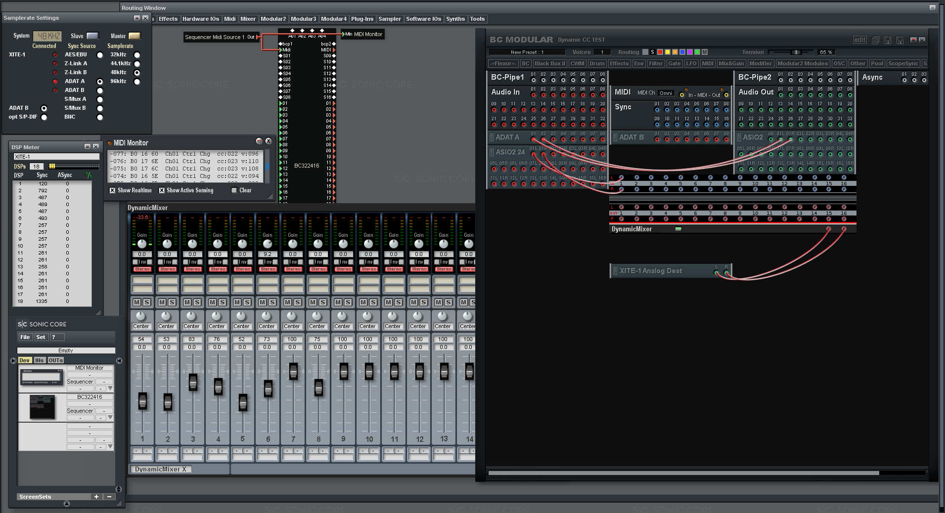

I've put this together with successful results based on the topic about the STM2448 not saving MIDI CC presets. I know this does not excuse the fact that there is an existing but that really should be fixed but right now things are what they are.
I have run my midi thru my DAW, you can certainly run your midi controller data right in the the Modular shell if you want and modify the module as you see fit.
Thanks a bunch to djmicron for the modular Dynamic mixer and Simon for the BC mod stuff. Maybe this will generate some more interest in that stuff.
btw this might have been done a long time ago but it was good to get back into the modular realm and practice again. Hopefully someone will make some use out of it.
BC Mod IV MIDI CC SAVE.PNG (277.06 KiB) Viewed 23096 times

Faders 1-8 are CC#17-24. Right click on the others to assign or change to your particular controller.
