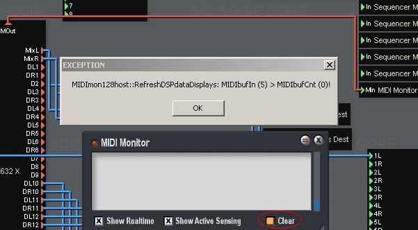

Midi-Monitor
error-message when press "clear" :evil:
since scope 5.0 x86
up to scope 4 was no error... on same system
Midi_Monitor-ERROR_but_NO_Crash (WinXP_SP3_x86-XITE1_Scope5_1).JPG (38.51 KiB) Viewed 4758 times

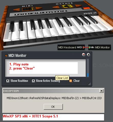

please note
XITE1: :evil:
PCIpulsar: :)

same error on
Win7 x64+xite1+scope5.1
roy thinnes

fresh project and only the midimonitor,
just the same ~ try and error...
but only with xite...

Don't bother about this. It's "normal" and no serious.
Re: BUG Midi-Monitor
Its an overflow on the buffer.
Always wanted a large MIDI Monitor for Scope that expanded to page size.
Just clearing the buffer an extra time works for me.
