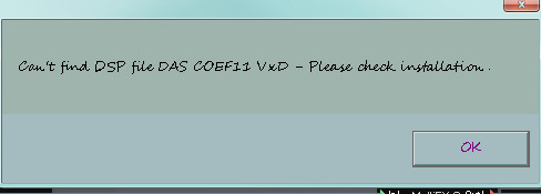

On my new W7 64bit pc with Xite-1, I get this message when I try to load any DAS xited device (I've found them in the DAS 64bit folder) :
I tried the .dev file from 64bit DAS folder & from xite update DAS folder.
With my ancient pc, it worked but I don't remember how I did... The only thing I remember is to have been take all the files in DAS 64bit or xite update folder, what I have done with my new pc.... :-?
Thanks for any advice !

the 64bit folder for DAS on the SonicCore ftp has the 64bit version of that file.

Thanks, !garyb.. But I don't find any 64bit folder on SC ftp ! :D
Just that :
ftp://sonic-core.net/software/3rd_Party ... AudioSoft/
but the files look the same..

Well... In this case, I already have the right files... :-?

re-copy/paste the file.
your are running Scope "as administrator", right?

garyb wrote:your are running Scope "as administrator", right?
Sure !

Oh ! It's working, now ! Thanks, Gayb ! :)
