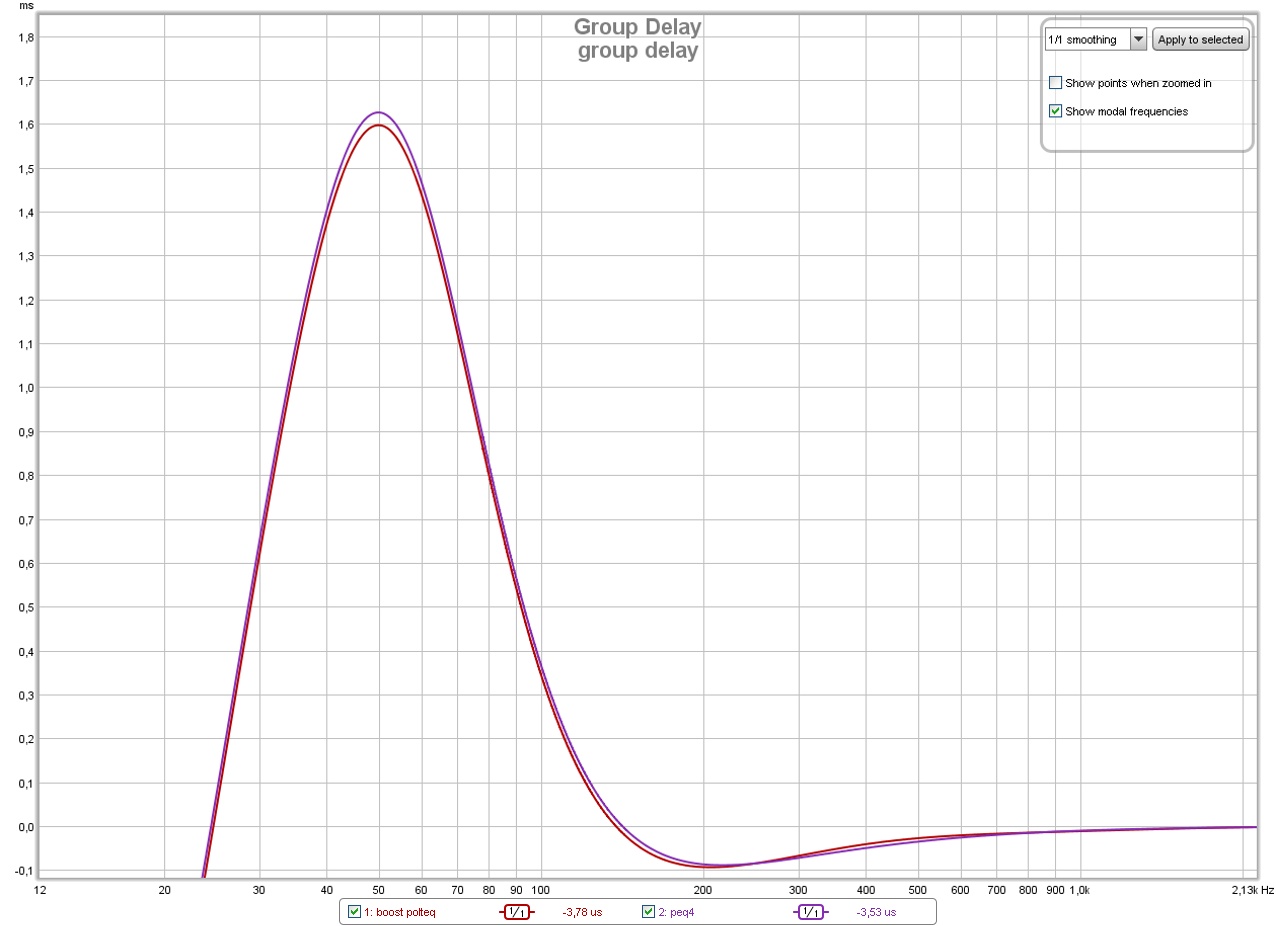

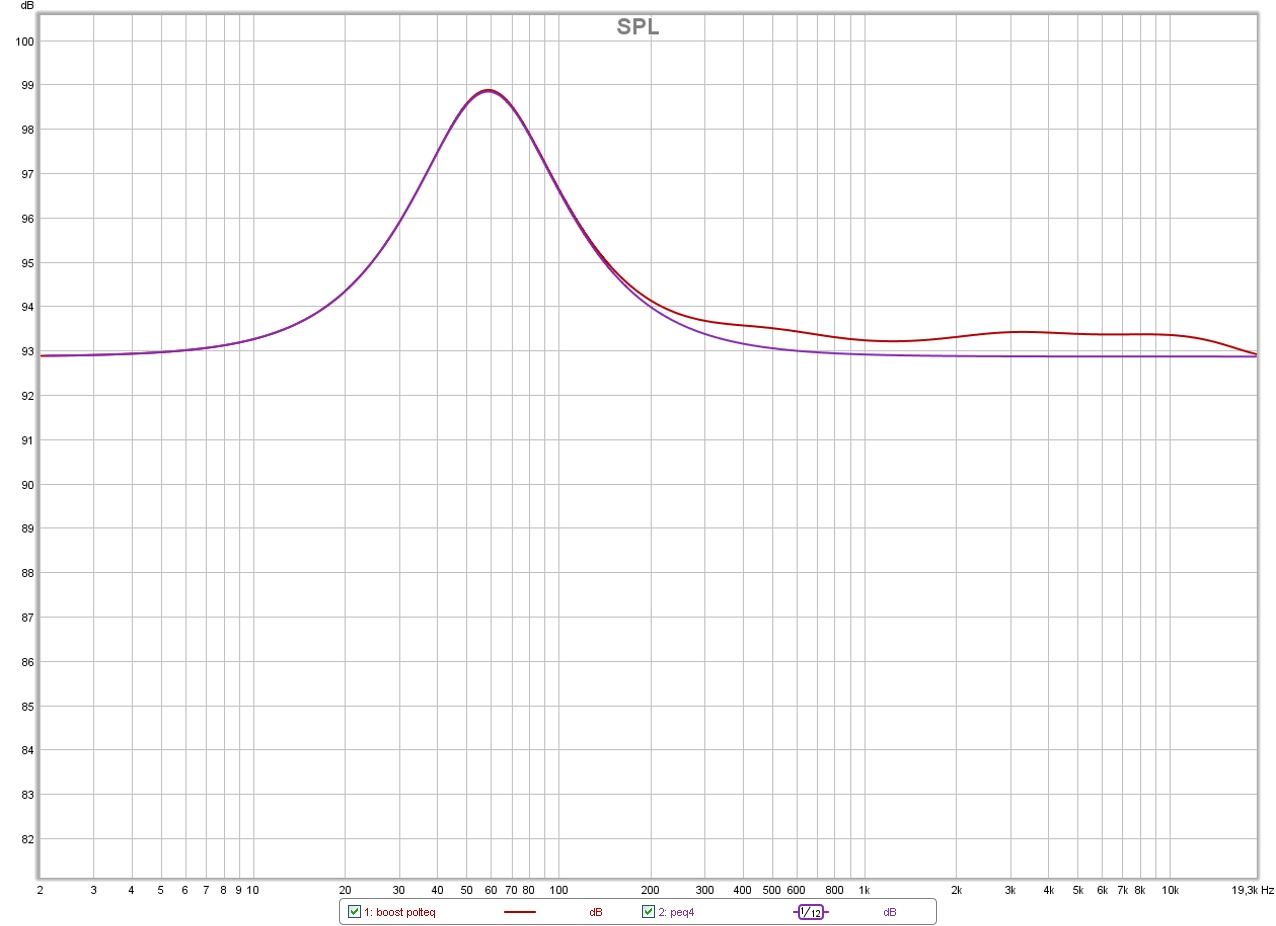

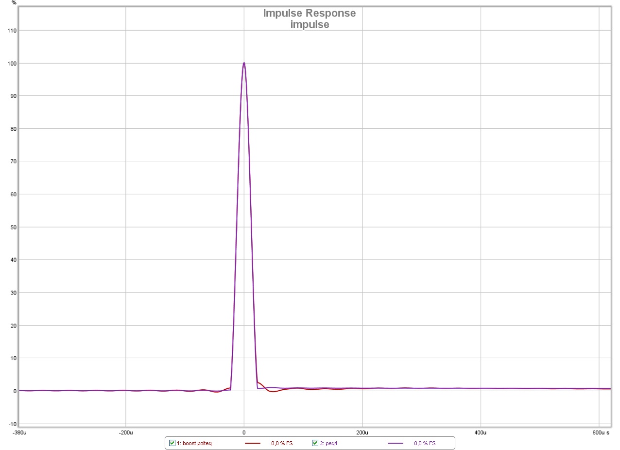

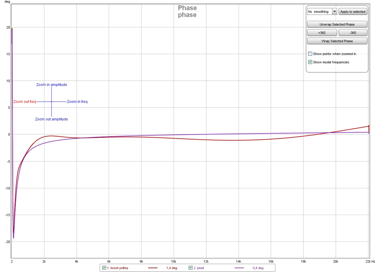

here is an objective feeling.
tested with REW, you should do some test before writing.
cheers
DAS
polteq vs peq4-phasel.jpg (131.03 KiB) Viewed 4672 times
polteq vs peq4-impulse.jpg (102.7 KiB) Viewed 4672 times
polteq vs peq4-groupdelay.jpg (174.32 KiB) Viewed 4672 times

and the 2 bandwidh
polteq vs peq4-spl.jpg (181.31 KiB) Viewed 4672 times
cheers
DAS
Feelings are never 'objective' :wink:
However, a phase cancelling test is objective, and I made that test for the first band. Another P member dit it for band two.
100% cancellation in my test, sorry, can't help :)
This doesn't disqualify the Polteq, denying the test doesn't help either :oops:
just show us this kind of test (ojective test) on every band you want of course, i'll show you that your tests are wrong.
100% cancellation = same phase curve
= same bandwith
= same group delay
= same distortion curves (harmonics)
so,just learn how to do some objectives test, with right tools, like ARTA,REW,HOLMIMPULSE....and many others.all are working with scope xite or pci,and are freeware.
goodbye.
