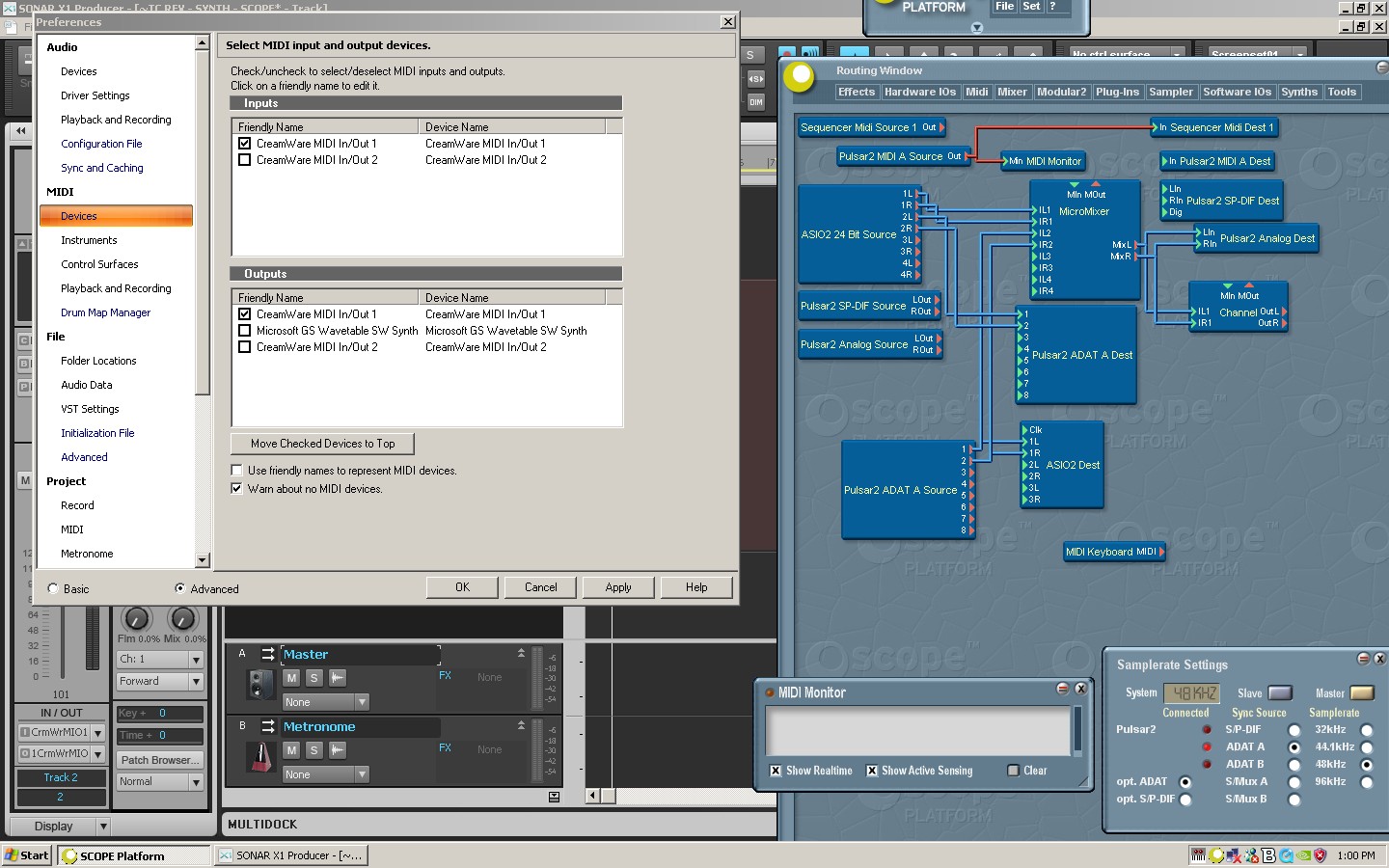

i want to play scope synth from another pc so i connect "IconnectivityMidi4+" din midi out to pulsar midi in. but not getting any midi data :( the midi out is working fine (if i connect a usb keyboard and select it from DAW and midi out to another pc/keyboard) plus rest of the pulsar2 fx/io is working great.
pulsar2 MIDI A source out: is the midi in... Right? ... maybe something silly mistake im doing :(
can anyone guess what could be the problem?
midi in pulsar 2.jpg (287.47 KiB) Viewed 3590 times

So your setup is something like this?
- PC1 is connected to the iConnectMIDI via USB
- iConnectMIDI is connected to Pulsar via MIDI DIN
- Pulsar is installed in the second PC2 (that is not connected to the iConnectMIDI via USB?)
- Sonar is running on PC2
And now you want to play a Scope synth from PC1, right?
Did you check the routing in the iConnectMIDI Config Application (from PC1 to Pulsar)?
And you want to record the MIDI data in Sonar on PC2?

To check if the Pulsar MIDI in is working properly you can simply connect a MIDI keyboard to it. Or connect the RME directly to it without the iConnectMIDI in between.
Did you already check the routing in the iConnectMIDI?
If the RME output and the Pulsar input are connected to the *same* MIDI port of the iConnectMIDI, then Pulsar will not receive MIDI data from the RME because the default setting is that the MIDI in data is not send to the MIDI output of the same port. It is send to the output of the other ports, though. So you'll have to change the routing in the iConnectMIDI Configuration application or connect the Pulsar to another port to make it work.
Re: pulsar 2 midi in not working
to test midi in,
connect anything that outputs midi to the midi in connector on the cable whip.
put a midi source module(Luna, Pulsar or Scope, etc depending on the card) in the routing window.
from the Scope midi menu, get a midi monitor and put it in the routing window.
connect to midi source module top the midi monitor and open the midi monitor.
send midi from the device connected to the cable whip's midi in.
look at the midi monitor while transmitting midi. you should see stuff(note on, note off, velocity, active sensing, midi clock, etc) happening in the midi monitor's window.

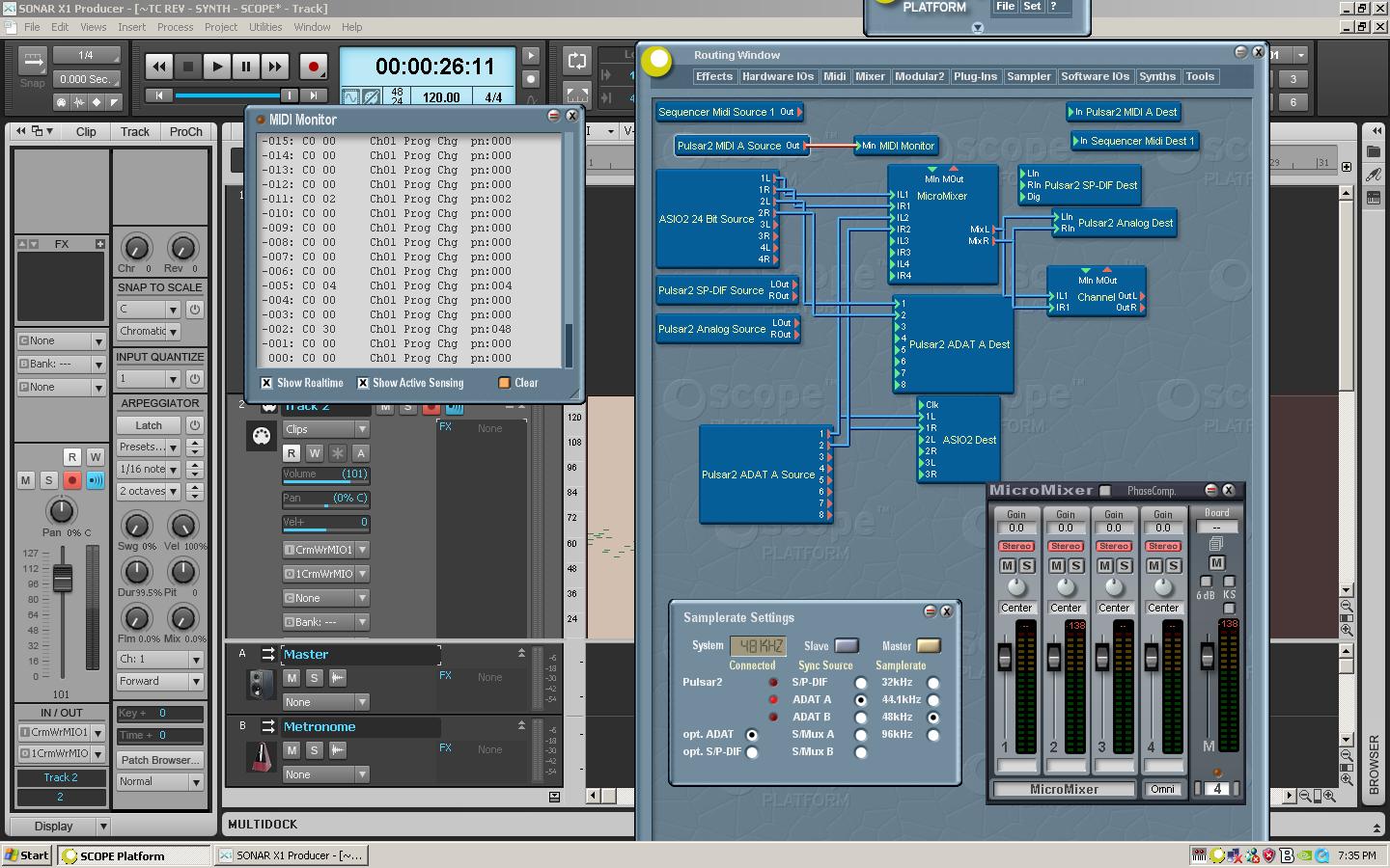

whatever i do (note on/of, pitch change, modulation change... ) all it receive program change message!
please see the pic.
prog change.JPG (238.43 KiB) Viewed 3494 times

That seems a bit strange. It looks like midi is working but maybe there is a setting on the hardware that is outputting midi that is ony allowing program change. At least there is some signal. Also is the Pulsar 2 cable whip still in good condition or colud that be causing some problem Two things to try next then.
1. Try using another midi hardware to output midi signal, for example do you have a simple midi keyboard that you can connect directly to the Pulsar 2 midi in.
2.Check the actual midi cable or try using another cable just to check if the same thing is happening.
yeah, i would say that the problem is in the unit sending midi to the card. it's obvious that midi is working.

garyb youre right. midi in connector is a bit loose :( i press it hard and it start working.. im afraid it will come up anytime :(
you guys are expert on scope cards... does a electrician can replace the connector with a proper midi socket :-?
thanks
yes, sure, it should be easy to replace. i'd wait to see if keeping it fully pressed in helps...
