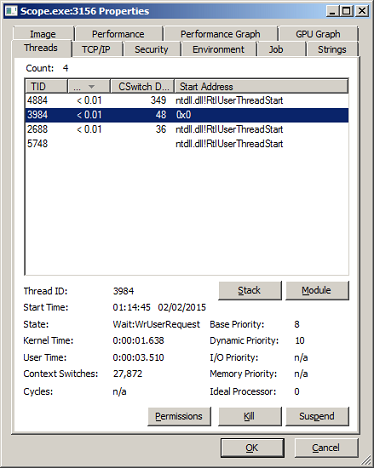

The way I understand this, Scope.exe and its libraries are not highly-threaded - Scope.exe, displaying it's GUI, and running a project containing ASIO and Midi I/O, shows only four threads running on my system, as you can see from the ProcessExplorer dialog for Scope.exe below. It appears that Scope.exe's four threads may all run on one core by Processor Affinity / Ideal Processor indicators, even here on Win7 32-bit on a four-core Xeon CPU.

So, like GaryB says, having no hyperthreading at the CPU is only a good thing for something like Scope. That's because its the SHARC chips in your Xite that's doing the parallel calculation-centric heavy lifting, not your CPU. It's also why older Pentiums, running older flavours of Windows, with none of the modern multi-core / hyperthreading support in the Kernel or at the hardware level, can run Scope OK, but would choke on something like a browser...
Indeed, it may be easier for the Windows Kernel Scheduler to schedule a lightly-threaded process, handling asynchronous I/O on IRQs, and where I/O Queues, Memory access (DMA) and Synchronization are implemented at the driver level....
All of which allow Scope keep it's Real-Time promise on Windows.
