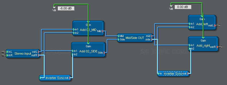

fra77 m-s module allowed me to understand why stereo field is altered with m/s devices !
Put fra77's module at the output of a ping pong delay, just put an amp gain on 'm' and another one on 's'. You think, hum... At least i (me, poor half-witted) thought I was going to increase the stereo field feeling by adding gain on 's' ... Have a try ! The field becomes thinner. Because additions & substractions need to keep the same value to rebuild the signal correctly, I guess. Thus it's quiet normal that by changing gain frequency (like in an eq) only on side or only mid, the stereo data are lost... Am I right ?
I'm realizing that in fact, it's very difficult to process mid & side in different way and get a nice stereo result ! I think that to keep the stereo image in a m/s device, some much more complicated processing is needed !! Brainworx BX, for instance, must have much more processing things than a simple m/s device like fra77 one's and a simple eq for mid signal & another one for side... And the stereo placement is drastically affected anyway.
Merci de votre attention. :D

M=L+R
S=L-R
So...how do you make it back to L/R mix?....basically:
L=(M+S)/2
R=(M-S)/2
That is basically the trick... ;-) It is no magic, just simple math, and a good judgement ear ;-)
If you put a encoder and decoder in series on a stereomix, it should be ABSOLUTELY THE SAME!!!!! If not....something is very wrong.
This is why you cannot take an MS encoder, chop in some EQ or comp, or seperate processing on one of the channels, and mangle it back together with the decoder....there is the delay. A good MS device is designed "as is"...like for example the dNa-Stereo Equaliser....all is in the device, and i can guarantee
phase-alignment is stable, no matter what scope-system you load it on, or when you reload your project (which can cause different dsp placements)
which will cause a horrible soundfield.
Re: M/s devices are nice but...
:) Brilliant, RA ! Thanks for explaination. That's what I undestood by experimenting with fra77 ms device. And I guessed it's a phase / latency problem which gave me this bad result. But you put math on what was just an intuition for me.
So what do you think about this way to do (mainly how L/R mix is build back) ?
I don't see any M+S/2 function to build back the stereo signal...But gain function is the same, isn't it ? And also, how would you advice me to check phase - latency in each part of processing ? I must tell you that I don't use SDK, if I try to make some "personnal" m-s processing, it's only with Modular or Scope -> with mathematical BCmodular or CWmodular modules, it's already possible but as you explained, I need to mesure / control perfectly latency everywhere to get a satisfactory result...
Thanks a lot !

i think in this the first gain adjust does the job for the /2 (it is because else the summed signals could clip.
If the level is exactly the same as unprocessed, the setup is correct.
The thing here with your setup....you don't know, and cannot control where the seperate modules are placed,
thus you can't predict what the latency will be.
The BEST way to test for correct phase: add a signal with the inverted signal.
In math ;-)
(signal a) - (signal a) = 0
So....
take L from the input, and take L from the output and invert the phase on the output....add those and
the result should be NO sound. (with processing the signals in /out are different, and then
a sample delay on the input could help for aligning the phase for maximum cancelation...
If you once heard what those phase issues sound like, it is easily recognisable.
Hope this helps, but it is a hassle in your setup / modular, cause when you find the correct delay, it could
be the next time you load your project or setup, the delay could be different.
regards,
ray
Many thanks, RA ! I understand everything ! And it's hapiness !
I still don't have the desire to go at SDK level yet.. I needed 7 or 8 years to get acceptable result with modular, so I can't imagine how many time I would need with SDK ! But advices like yours and many other people's on Z satisfie me.
The m-s jpg was given to me by someone here some years ago but I cant remember who.... I thank him anyway ! :D
