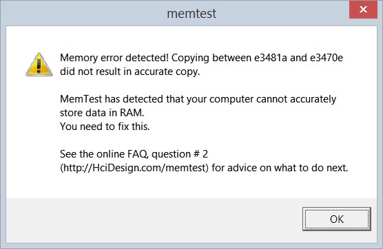

Im going to run a MemTest on my ram, sadly i think one of my chips is corrupted.(ddr2)

Just as I suspected:
I order new Ram sticks so hopefully i can get to use these modules, really miss my Scope songs.
