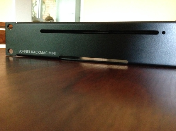

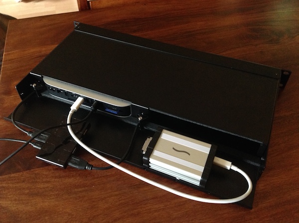

This is my Mac Mini in a 1U Sonnet Rackmac Mini with the Sonnet Thunderbolt ExpressCard Adapter housing the Sonic Core ExpressCard:

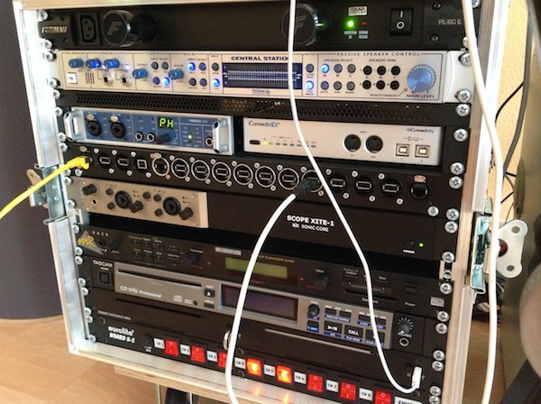

And this is the rack:

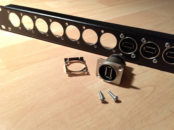

I use the two USB ports at the front of the Rackmac Mini to connect the keyboard/mouse to the Mac (and a USB stick or an iLok for example). There are even more USB ports in the rack panel above the Xite. Some of these are connected to the Mac Mini and the other ones to a USB hub that is attached to the iConnectMIDI 4+ (for MIDI controllers). There are also some Ethernet ports in the panel. Both, the USB and Ethernet ports are actually just Neutrik feed-through connectors:

dante wrote:That rack USB unit - I need one of those !
Yes, these are great! Search for rack panels for the Neutrik D-Series Connectors.

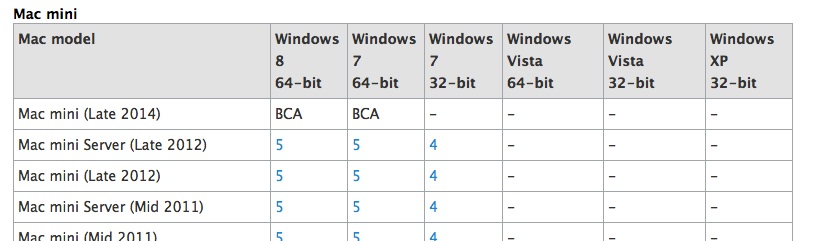

Apple has already updated the compatibility table and added the new Mac Mini model that came out last week.
http://support.apple.com/kb/HT5634 (same link as above)
BCA refers to Boot Camp Assistant and 5 and 4 are the Boot Camp versions to be used.
Interestingly the Late 2012 models now also support Windows 7, 32-bit.... hmmm, I wonder if they changed this with an update or if the old table was just wrong? Or is the new table wrong? I guess, I'll have to try to install all again with Win 7 32-bit then...
