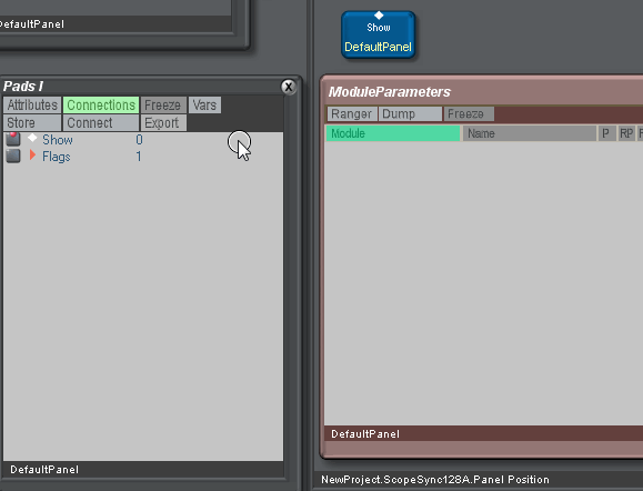

Are people using the ModuleParameters window successfully in SDK5? I downloaded the extra .pep script package and put it into the App/Script/App folder, which means that the window now loads, but I can't add new Parameter entries to it. I can edit existing entries, or replace them, but dragging a Pad into the window doesn't do anything. I'm still very much a noob at the SDK though, so I could be doing something daft. Here's a capture of what I'm doing:

Cheers Søren, great tip to check that doc. So, the key is to drag the pads into the ModuleParameterTree, not the ModuleParameters window. Once they're in there, you need to hit F5, which refreshes the view in the MP window and voila you have your new Parameters.
One other gotcha is that it seems the two can get out of sync, so if the MP window has entries that the MPT doesn't, you can drag from the MP to the MPT initially to get them back in sync. Otherwise, as soon as you add to the MPT, it'll clear the other entries from the MP :) All makes perfect sense now!
