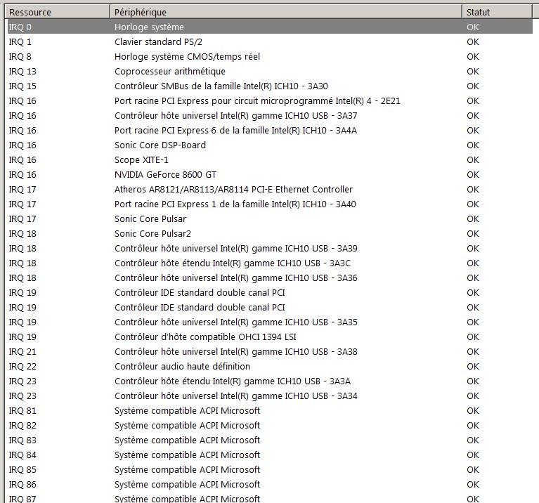

Yes, I did it yesterday and get blue screen... And after that, Firefox was unable to restore the last session, which I hate. I can continue to live whithout the 1610 ! I'm totally unable to find why only the 1610 does blue screen of death. Do you have any idea of what I could try to do ? All other plugs work fine. I only have some issue with very old vu meter (extreme vu-meter 1.02 designed by s.baan) : when I save the Scope project, scope crashes...
So my system is quiet stable, so why only 1610 ?? No idea. Never mind.

irq....
Re: DAS AI Electronik specs
Ah.. Yes, irq. I did all I could with them ! I don't have anymore to release.

JoPo - put picture of your IRQ ! 'a small drawing is sometimes better than a long speech'
Voilà voilà ! (in french...)
I know, i know the ieq 16 has Xite + scope pci + video board ! But what to do ? I don't have any device to switch off anymore. I already tried all slots for the scope pci boards.
it's probably the usb controller 3A37 that's the problem....try disabling it.
if you are online while working on music, the ethernet controller also might be an issue.
i'll bet that a little slot shuffling would help, if you have slots to shuffle, but the usb controller definitely should be disabled in the device manager, at least.
I need all usb i/o ! Otherwise, I would have disable it already.. My pc don't do only music.
too bad, use a hub. :)
you don't need ALL of those usb controllers.
