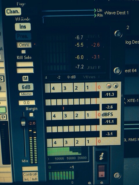

So who do I believe ? Abelton Live says -6db my meters in scope have a different story to tell ..Scope looks like it is agreeing ! Should I just ignore Live

meters are not absolute things. 0db is not the same everywhere as the scale depends on the reference level. believe the Ableton meters in Ableton and the Scope meters in Scope. they don't have to agree, they just need to keep you from overdriving the processes in either system.
harware systems, tape decks and mixers used to have adjustable meters. the engineer was expected to run a reference signal(determined by a specific voltage at a specific frequency) across all of the gear, and then adjust the meters to match each other.

Thanks Gary but still makes no spence to me -6 db is -6db. I am told to mix down to -6db for mastering. Is there any digital meter that is industry standard? I guess as long as there is headroom I should not worry about it :roll:

no, -6db is NOT -6db.
the scale is relative to the reference voltage(which doesn't really exist in digital). -6db is a RELATIVE number, not an absolute number. there is no such thing as an industry standard, although there are two or three reference levels that are most common.
no, you shouldn't worry about it. the only problem is if a digital device shows more than 0db on IT'S meter.
