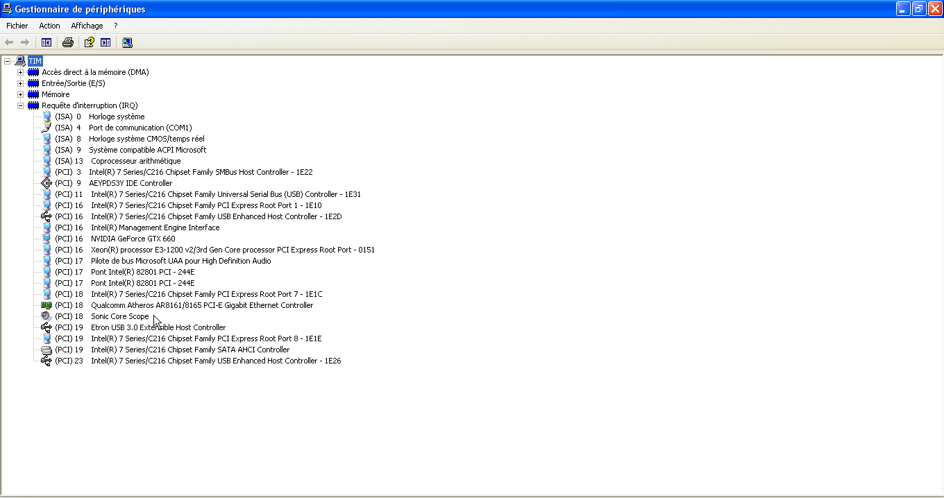

Re: Freeze The pc Only With Xtc ,energyXt Flstudio And The o
what's sharing an irq with the Scope card?
Post by heiwa_boken »
hello
how can I change irq??
you can't.
you can move the card, you can move the ethernet card(if it is a card) or you can disable the ethernet controller in the device manager.
i'd try disabling the ethernet controller just as an experiment.
i try disable the ethernet controller
My computer still freezes
