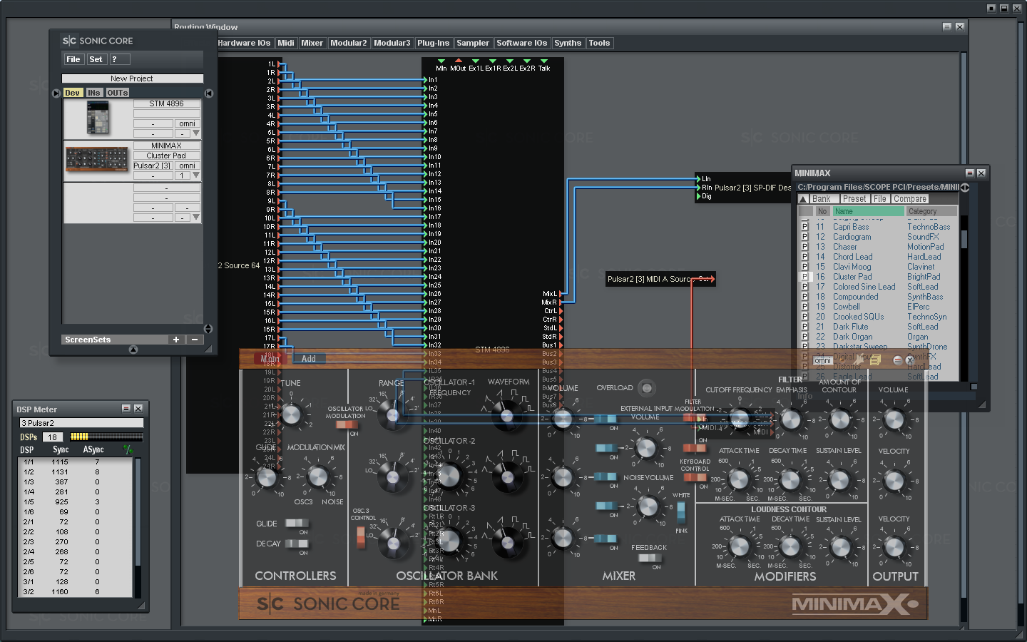

Post a screenshot of your synths and livebar.
Re: Synths are not polyphonic
see that "1" under "omni"?
that's the number of voices. you can choose how many voices there.
many synths like the minimoog are not poly synths, so you might want it to only have one voice. since one voice takes about 2 dsps, you also wouldn't want more voices than necessary.

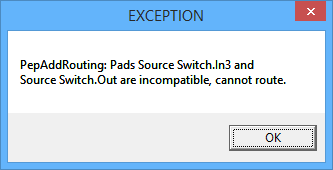

Got the following as well:
- scope.png (3.19 KiB) Viewed 2227 times
routing mistake or project corruption(the warning)....
you only need one card with a license per computer.
