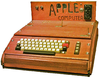

Things have to start somewhere.
Still kute to see, one of the 17 or so remainingt Apple 1.
At least you can say that the box was completely accessable and changeable:
