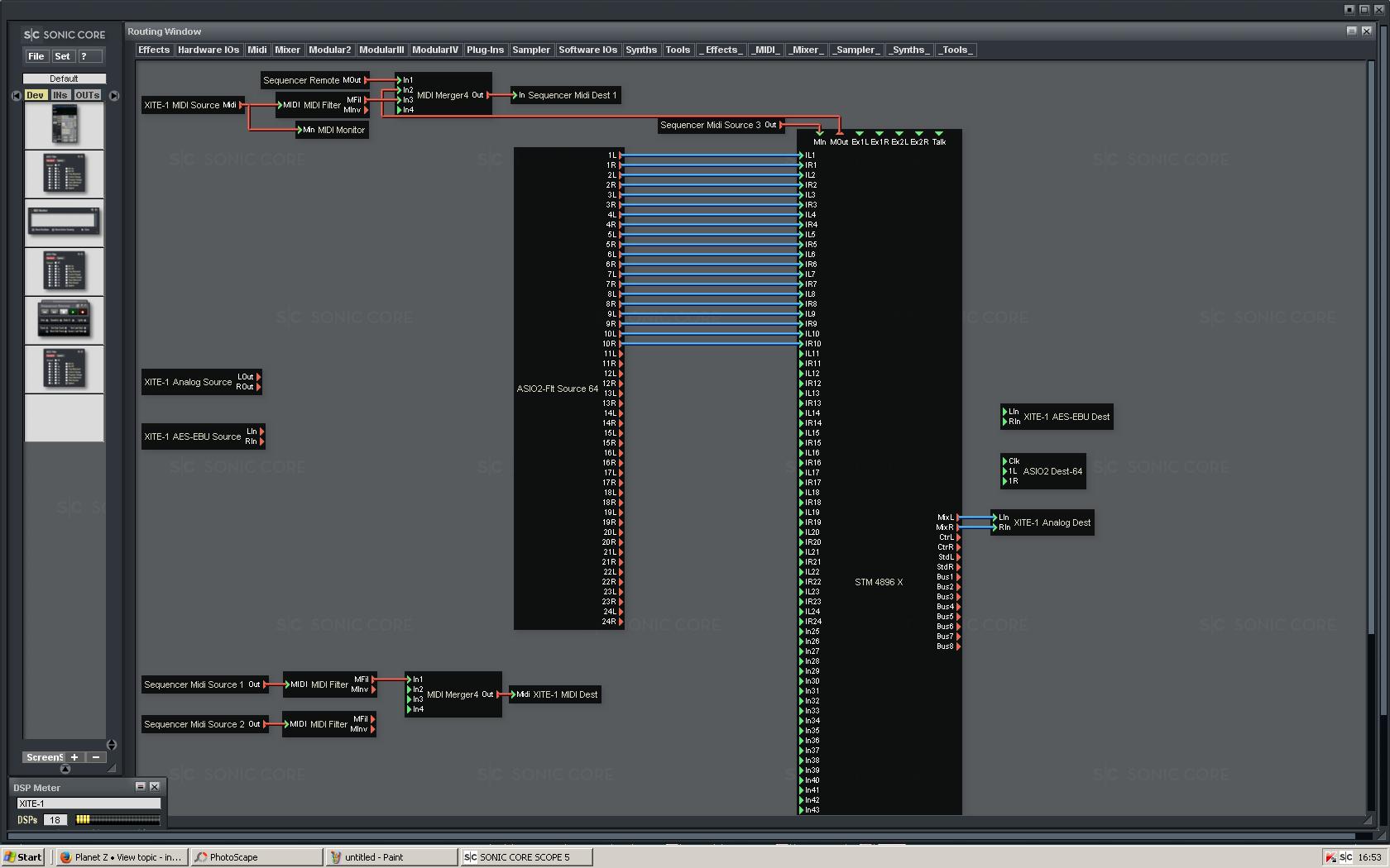

If you look at my screenshot I arrange freebies and older stuff in folders similar to the original Scope names, but with a "_" to push them all to the right hand side of the menu bar. This means I can easily copy over old stuff when installing without trying to figure out where it all goes.
