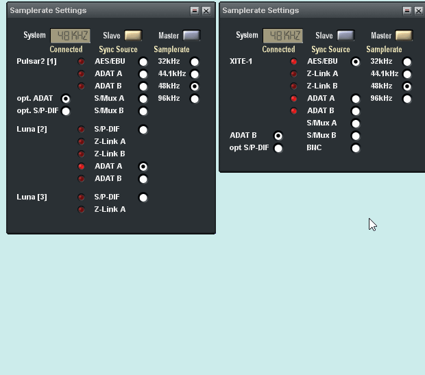

Here's what I need to do from time to time (mainly after bootup) :
1. Change sample rate on Master (XITE) from 48 to 44
2. Wait
3. Answer 'Allow different sample rates' to popup from Cubase
4. Wait.
5. Change sample rate on Master (XITE) from 44 to 48
6. Wait
voila...no more crackles !!!
