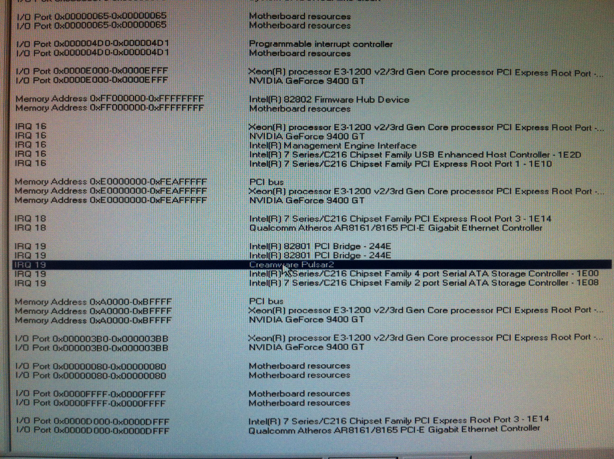

I go to the system information and I made a pic for you to see, becuse I still don't know what to do.
I do have 1 usb ( of the wireless keybord and mouse ) that allways conected.
I can see that some things are use the same irq 19 with the scope.
can I some how make changes, so the scope will have his own irq?
Re: PLEASE HELP !!!
thsoe things that are shared shouldn't be a problem, but if you have another slot, you should try moving the card to another slot and then check again.
