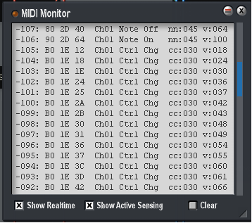

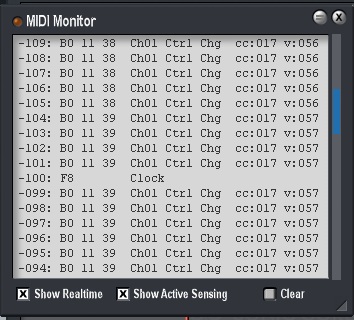

minimax filtersweep. midimonitor screenshot from recording. standard live automation.
- Wishlist: SC, please make capturing long strings in midi monitor possible :)
- DEMOMMX.jpg (62.51 KiB) Viewed 2598 times

Re: Using Ableton Live 8 with Scope
first was with scope master, no sync.

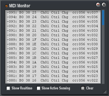

this one with scope master, sync enabled.
no external midi gear, no "special" options. I seem to remember to have done something with quantizising regarding the effect you have, but cant recreate it...

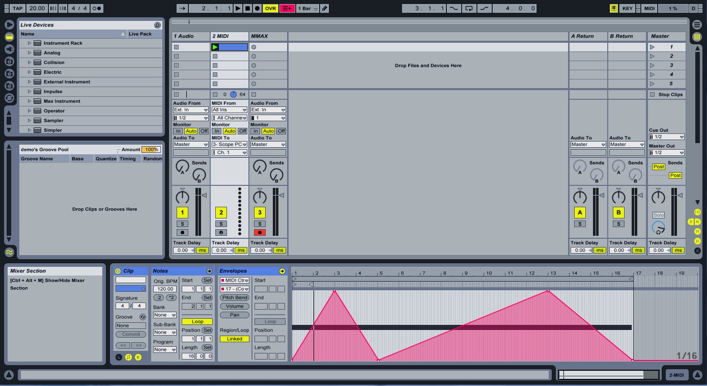

I use live 8.2.something, iuse regulat midi CC automation, the regular line plus points envelope if u get me (as in not the draw option. if u use the draw option, be sure to disable the fixed grid) .
- 2sync.jpg (46.5 KiB) Viewed 2589 times

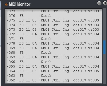

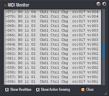

Here's what I'm getting:
Not exactly smooth...

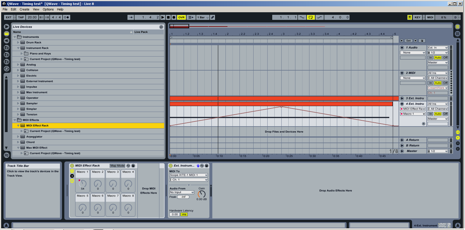

Ok - I managed to get a better and actually decent result:
I achieved this by using Live's arrangement view automation.
A gained access to this through a combination of Live's External Instrument and Live's Midi effect rack's macro control panel, which enables me to assign 8 CC's (Without the need for M4L!):
Why this gives me a more smooth result than assigning cc's in Live's Clip envelopes, I have no idea.
Did you use the same method or did you use Clip envelopes?
Still when I look at your screenshot of the midi info, it seems like you have an even better resolution, or at least your midi monitor is updating at a higher frequency than mine?
hey
i use standard live automation. as you see from the screenshot i went down to 20bpm as you have and tried the same sweep, my sweep was at 120bpm.
same smooth result. Did you experiment with quantisize on/off and other similar options?
