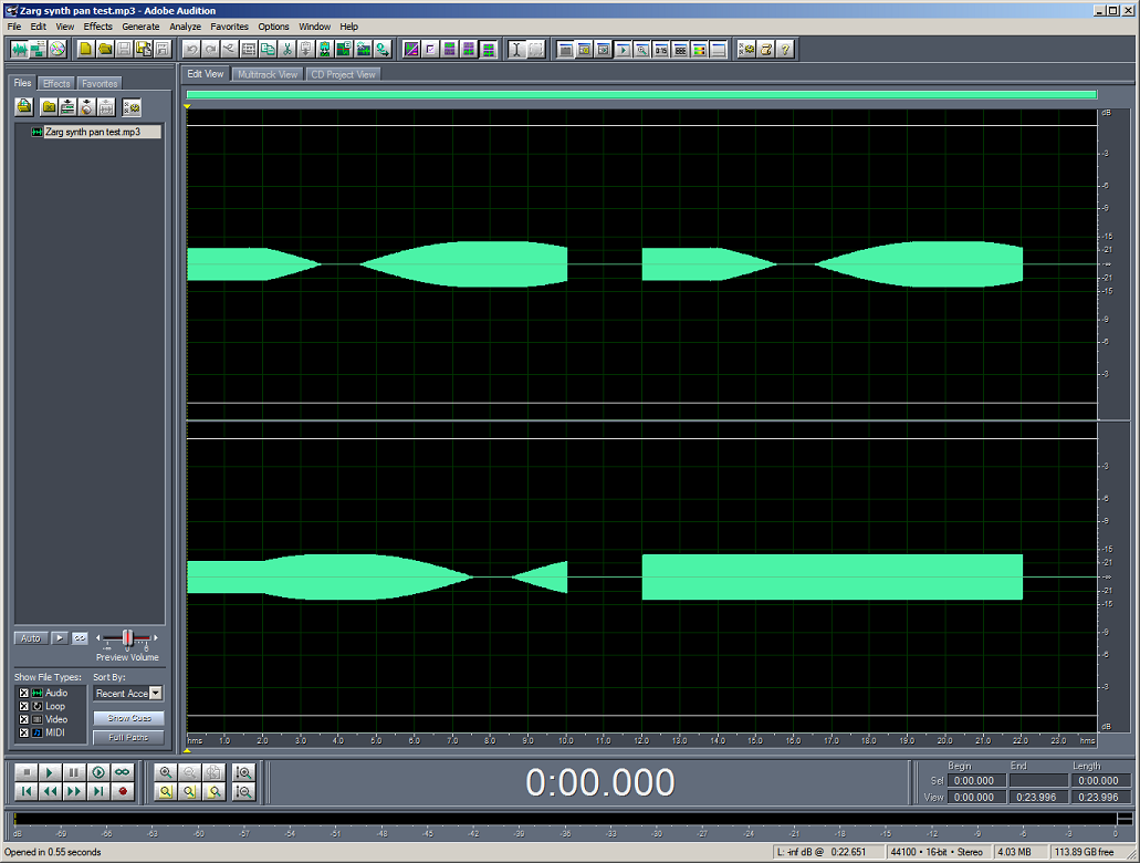

ok,
For this test I loaded the Qwave synth on both my pci (Scope v4.5) and xite-system (Scope v5.1).
1. Then I loaded the preset "full reset 2" which you will find in the Benoist Guitton preset bank.
2. I then turned off instrument 2, so that only one instrument is on, running only one wavetable, with no effects or any other "fancy" stuff going on in the patch.
3. In cubase I set up a simple note on each synth, which starts playing in the center and by midi I control it to pan all the way to the right, then pan all the way to the left and then back to the center again.
4. On the attached recording you will first hear the above described test played through on my pci-system running scope v4.5. which sounds as I would expect it to. Then there's a small pause, and then the same test played through on my xite running scope v5.1. You will hear that the first part sounds right. It pans to the right as expected, but once you get to the part of the test where it should start to pan left, what you hear is that the sound is still "centered" and the only difference you hear is a small increase in volume.
If you look at the attached sound example in a wave-editor, it is easy to see the problem.
5. I got the same problematic result on my pci-system when I had Scope v5.0 installed.
- Zarg synth pan test.png (178.29 KiB) Viewed 11321 times

you found a bug. i'll let John know.
it seems that the left doesn't cut when panned to the right. i think it might not be that obvious, depending on the patch, but it's definitely happening.
