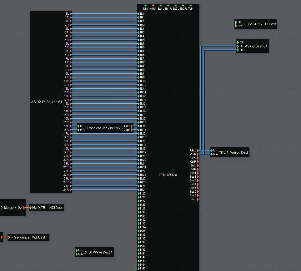

The beauty of Scope is you do not have to go outside of it at any time. I do not understand why you say the Mackie limits you to only using VST effects. Scope is hardware, integrates with hardware pronbably better than any other system because it is completely configurable. The thing is a giant routing box, as well as synths, effects and mixers etc.
I do not know your exact set-up but I can guarantee that I could get a Scope set-up and project going that would integrate the Mackie and the DAW very easily. Do you record the synths on individual tracks or mix on the Mackie and record a stereo mix in your DAW? Personally I would track synths individually straight into the UA, using the Mackie for monitoring. I bus BFD2 to Scope for mixing. Everything goes through Scope. There is no bouncing, only recording. I like to listen as I'm recording.
You can route everything internally in Scope - no AD or DA required. It's all do-able, but you may need to reconsider your working methods slightly.
All you need to do is track everything like you would on a multi-track tape session (remember those?). Then bus it all to Scope on ASIO outputs, add any effects, run those outputs into the Scope mixer and back out to your DAW's ASIO inputs to record (or you can use another recorder if you prefer). The advantage of this is that you can do anything in Scope in terms of patching, effects order etc. and it also means you have recorded all the tracks which you can keep as individual stems if you ever need to go back to remix it.

Re: Which version of Cubase works best with Scope 4.5?
quantummastering wrote:This way I only record once because I don't like to record samples again.
Don't really see the benefit of this - once it's digital a sample is the same as a piece of audio, we just arbitrarily give it a different name.
quantummastering wrote:As for realtime recording through Scope's mixer, do you mean route each Scope mixer channel output to each ASIO DEST channel?
This is what I mean:
I am routing from Cubase (ASIO Source) into the Scope mixer and then recording that onto two tracks of Cubase (ASIO Dest) and on track 16 you can see I stuck in a Transient designer before it hits the mixer.
What effects are you automating? There's no reason you can't use Scope effects and VST effects and hardware effects - it's not exclusive, that's the joy of Scope.

I am using a STM1632 mixer that has direct outs. I am wondering if there's more quality gain in sending direct outs to another DAW using ASIO DEST than only using the main out like in your picture.
And for FX, I'm usually using a delay, reverb, and compressor, almost never eq. Sometimes I need to automate the FX MIX.
So you're saying I would be able to create a MIDI automation track in say FL Studio and route it to a Scope effect, using a Sequencer MIDI Source module inside Scope?
