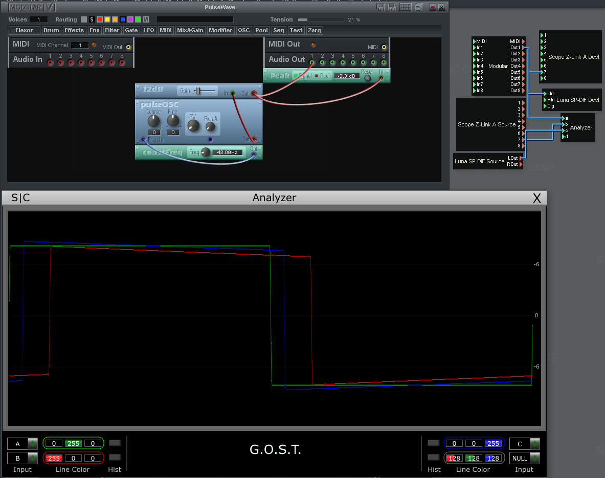

I did a little latency test by measuring the phase shift of the waveform using the Analyzer.
Green = Direct output from Modular 4 (the catcher signal)
Red = Return signal from A16 Ultra (connected to Z-Link)
Blue = Return signal from Fireworx in bypass mode (connected to S/PDIF)
The waveform is 43.09 Hz
1000 ms / 43.09 Hz = 23.21 ms per cycle (the Analyzer is showing one full cycle)
The analyzer display is 1024 pixels wide
A16 Ultra Z-Link roundtrip
(23.21 ms / 1024 pixels) * 80 pixels = 1.81 ms roundtrip latency
S/PDIF roundtrip
(23,21 ms / 1024 pixels) * 28 pixels = 0.63 ms roundtrip latency
If I made a mistake in my calculations then I hope someone can correct me
S/PDIF roundtrip
Tip: The G.O.S.T. logo is a freeze button

the lighter points are measured values
whereas the darker points are interpolated to draw a line between the measured ones;
1 full periode is determined by the framesize of the display vs the framesize of the samplerate;
fp=sr/fs // 44100/1024=43.06640625 Hz;
time_in_milli_sek=samples/sr*1000;
1024/44100*1000=23.21995464852607709750566893424 ms frame you see at once
80/44100*1000=1.8140589569160997732426303854875 ms latency
yes absolutely correct but
i wouldnt have expected the source to be modified when bypassed;
also i do not see the dB raster is it PNGed away?

The speed of sound is 340.29 meter / swouterz wrote:A16 Ultra Z-Link roundtrip
(340.29/1000) * 1.81 = 0.6159249 meter (= 2.02075 foot = 24.249 inch)
So in 1.81 ms sound can travel 0.62 meter through the air. My monitor speakers are further away than 0.62 meter so the biggest bottle neck in a Scope system (latency wise) is nature itself
