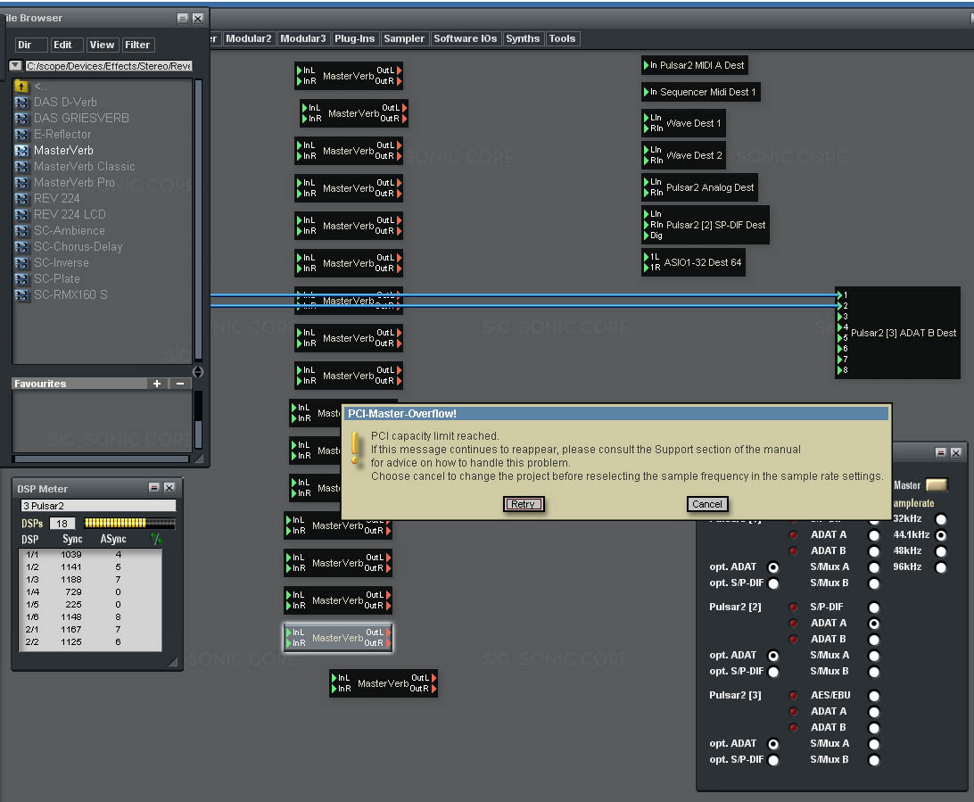

Right, I've rebuilt my DAW with a Gigabyte GA-P75-D3/I5 Sandybridge and done a quick in place XP install so the drivers were all still on the original hard drive. I installed Scope 5.1 and copied my original Scope folder over the new install (I usually do this if I reinstall so it keeps my settings etc).
Inital results were better than I could have hoped for. I managed 16 Masterverbs with a PCI bandwidth error at the 17th. I even connected the 16 Masterverbs in a chain and got sound going through. This is better than I used to get with a CUSL2-C and a P3-800.
DPC latency is 15-16 uS with Scope running.
I hit a snag when I tried loading an old project; the PC spontaneously rebooted. I narrowed this down to Masterverb Pro, putting one into a project causes a reboot. Mixers and SC reverbs are fine. I suspect that I need to do a proper format and reinstall.
So far so excellent.
Stratt

- masterverb_test_B75.jpg (168.38 KiB) Viewed 6347 times

Hmm, it may not turn out to be quite as good as first results suggested. Now that I've done a new install of Scope 5.1 I'm getting around 6 instances of Masterverb before the PCI bandwidth capacity error. I can add a few more, one at a time, and the system works well with no spontaneous reboots, but it's not as good as the P5K board with Wolfdale processor. At least it's much better than boards with the PCI to PCI-E bridge.garyb wrote:that is really good news!
i'm looking forward to a good result in actual use...
Real world tests to follow.
Stratt

It appears to be OK for Scope cards, not brilliant. The Masterverb test generates an error on the 7th Masterverb, which is half that of older boards like the Asus P5K or the even older Asus P4C800. It does seem stable though.Polarity wrote: Let us know if it's good for Scope cards.
An i7 seems overkill for a DAW, especially when you have a Scope based system. I'd go for an i5.Polarity wrote: Thinking about upgrading my DAW to a i7 system in january maybe.
This could be an IRQ problem. How many Scope cards do you have? Can you move cards around? Perhaps disable unused devices/usb in the bios or disable network cards in Windows.Polarity wrote: I'm starting to have enough of the unresolved issue of of crack/glitch in the sound with Cubase.
An HD7850 is massively overkill for a DAW.Is your PSU powerful enough? It could explain the BSODs you've experienced. I use a fanless HD5450 with 512Mb to feed twin widescreen 22" monitors.Polarity wrote: Also have some issues with the new video card (Asus HD7850)
I use XP and have no plans to change to Windows 7/8. XP is less resource hungry than Windows 7 and for some reason some of my larger Scope projects are fine in XP but are too big for my DSP in Windows 7.Polarity wrote: Just thinking that my mainboard was not born for using Windows7.
infact it is older even than the announce of that OSand got problems since installing (had to update BIOS just to make Win7 install for example).
I'm going back to using my Asus P5K with Wolfdale E8400 for the moment. Some of my big projects generate PCI bandwidth errors with the GA-P75-D3, and the benefit of having four PCI sockets does not outweigh a wider PCI bandwidth.
Stratt

I am still working on the P5K. The B75 board proved to be problematic; one of the four PCI slots appeared to have a problem recognising devices plugged into it so I'm using it elsewhere for non music stuff. I don't know if this is a design flaw or if there's a fault with the board. I'm still interested in trying to find a new board that can do three Scope cards with good PCI bandwidth plus my SW1000XG, but it's not a huge priority.
