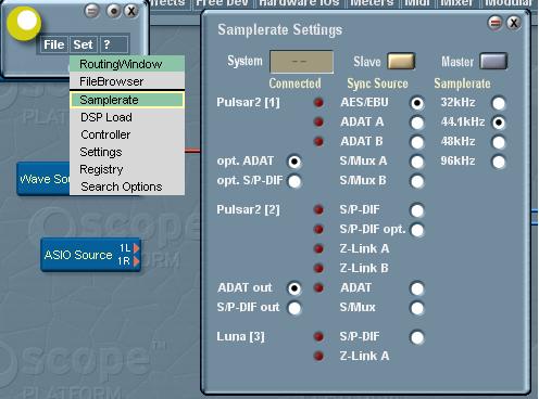

Since you are slaving from the Lavry to Scope(I imagine), then you must set Scope to Slave by way of the Sample Rate setting in Scope.

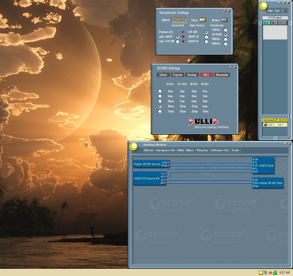

Actually I figured it out just now. I replaced my XTCProject project with the original version and now it mysteriously works. I even removed the 'merge' and 'directplay mixer'. The original project also has 4 ASIO ins and outs, mine has 2 ASIO ins and outs. So that was the problem all along. I needed to double the number of ASIO channels.
So yes you can do simultaneous playback with Pulsar 1 and Scope 4.5. Just set one track for output only and one for input only. You can also mute the input track so that you don't get some nasty feedback.
Here's the working project:
