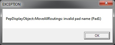

When loading a project that has a number of CC assignments to the mixer (STM4896) I get an Exception error:
PepDisplayObject::MoveAllRoutings: invalid pad name (Pad1)

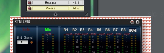

Also, any open surface has a bizaar white with red triangle background?
I've attached pics of both.
Once I click OK, the project continues to load and the strange graphics go away and everything works as it should - CC assignments included.
Its not a major problem because this particular project continues to load after clicking ok but this is the 2nd time its happened - the 1st time I wasnt as fortunate and the project would load but not work.

Re: Exception Error When loading project
if you want saved automation to work properly, make a midi preset for the device and then load the preset once the project loads. something is corrupted in that project, but it's a minor issue.
