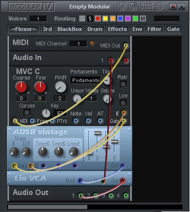

The more I play with my new MFB Kraftzwerg synth, the more I realize that I need additional EG/VCAs. It has three oscillators, but I can only use them for stacking since it only has one VCA. If I had a few more VCAs, I could create separate MIDI sequences in Live and send them to the Kraftzwerg on each oscillator (either as MIDI or as CV using Expert Sleepers Silent Way). So is there a software plugin in Scope or otherwise that simulates an EG/VCA? Right now, I can route the audio of an oscillator into Live and it plays constantly. I just need a way to shape that sound using my MIDI input as a gate. Maybe the Scope Modular has such a thing. I haven't done anything with audio input in Modular before. Thanks!

Sure, quite easy to achieve with Scope Modular.
The drawback being, once you taste modular stuff and get into it, it is hard to come back to some more fixed architecture solutions.
Thinking about it, it is just similar to Scope versus any other solution actually ... :)
Re: VCA plugin
If you only want a midi triggered EG/VCA for an incoming audio source its very easy to achieve.
You can ofcourse do a lot more between input and output, but this is the basic.

Thanks!! It works great! I've been reading the posts here regarding using Silent Way with the Scope Modular. I can't wait to see what type of hybrid modular I can make between the software and hardware. This is really fantastic!
