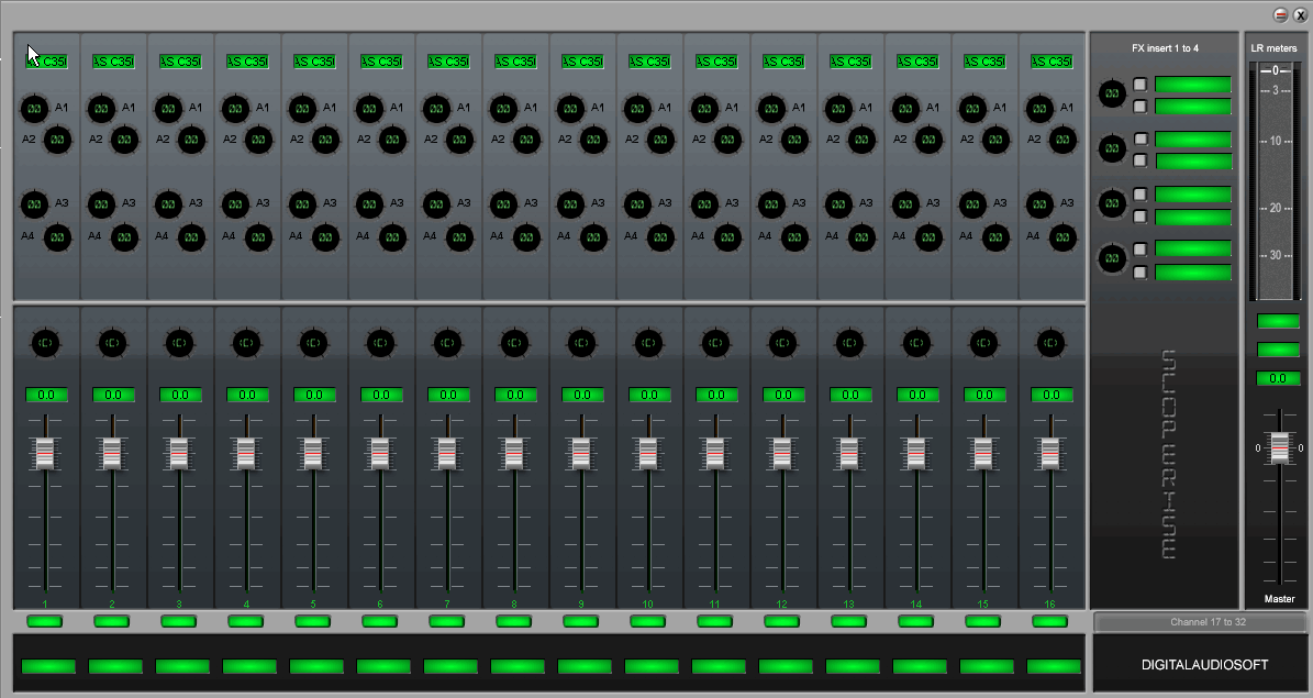

Posts: 5052
Re: PCI Firewire card issue
Not only that but with the new DAS Optimised C350L version, its possible to run 32 instances (@ 44.1) as inserts in a 32 track mix - and that just on the lower DSP XITE-1D.
DAS C350L lots loaded
DAS C350L x 32.gif (508 KiB) Viewed 2584 times
