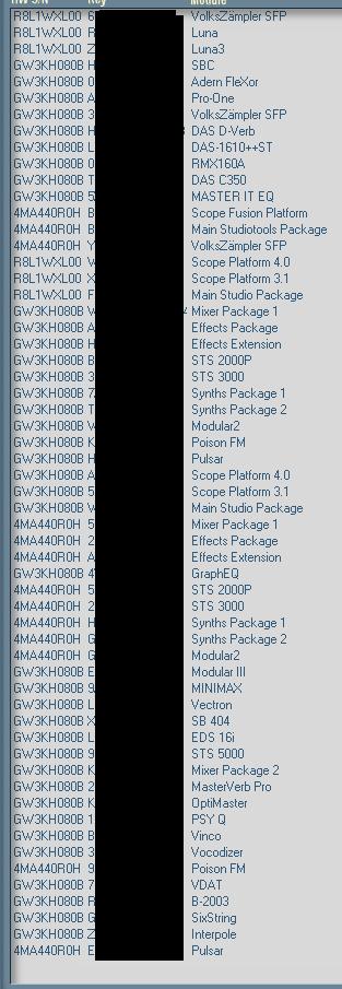

I am using Scope 4.0 as 5.1 is having issues with the STS samplers, my question though is, is the STS 4000 not included with SFP 4.0, I do have STS-5000, but no 4000?

you should probably have a 4000 key. does it matter? you have the 3000 and 5000, there's nothing that the 4000 does that you don't have.
still, it shouldn't be too hard to get a 4000 key.

The reason I'm asking is that the STS-3000 goes no higher than 32 voices and only 8 outs, The STS-5000 can go higher but will not do 64 voices(DSP STDM errors), so I'm reasoning that the 4000 can get the 64 voices as it has slightly less resource requirements than the 5000, but more features than the 3000, if I'm wrong then yes there is no point.
90% of my work is done through the samplers, ala workstation style(Triton,XP80) lots of instruments, not really sampling per se.

since you only have 3dsp cards(i think that's correct), big devices will have to span between cards(if that's even possible), leading to eventual s/tdm errors. the 4000 might do as you think, but i'm guessing it'll be pretty much limited at the same point that the 5000 is.
if you're composing and recording, you can just commit some things to "tape" top save resources. parts that aren't going to get changed for a while don't need to be loaded. it sure is convienient having all the samples ready to go, though, i'm sure. :lol:
if you want a sts4000 key, it should be as simple as writing to support. with Messe just ending, it may take a few days.
