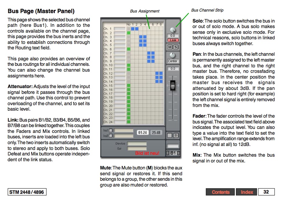

If it's about STM 2448 / 4896, maybe page 32 of the manual helps.
- page 32.jpg (295.96 KiB) Viewed 3712 times

Yes its about that page I dont understand how to activate.Janni wrote:If it's about STM 2448 / 4896, maybe page 32 of the manual helps.
The blue is automatic from loaded plugins but ???
I get no signal at all.
Also what is ment by linked together here.

Re: The busses
The blue buttons are the buttons for assignment.
That means (in this picture):
Ch 1 goes to Bus 1&2 (linked together, red link button)
Ch 2 goes to Mix (green button)
Ch 3 goes to Bus 3&4
and so on...
AFAIK you can't send one channel to several busses.
That's really limiting, IMHO.
But I'm not sure about that, haven't used that mixer for a long time...
As long as you haven't activated the green mix button on the Bus channel strip (right bottom,
next to the defeat switch) the signal goes only to the Bus output and can't be heard on the mix.

Thank you very much, i am going to try to activate today.Janni wrote:The blue buttons are the buttons for assignment.

the description from the manual is about the record busses, usually called "bus".
