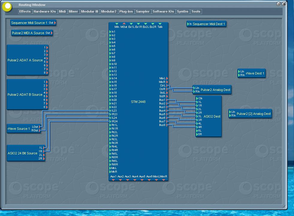

Re: Lost audio in and out
Yep that helps,Had a long chat with Gary B and all is well.I even got Samplitude working again.Its not done yet but here is my routing window so far.Well i thought i could post the screen shot,i have it on a flash drive but the forum says the extension bmp is not allowed.
Save it as .jpg (JPEG).
Looks like it worked this time
- here ya go
