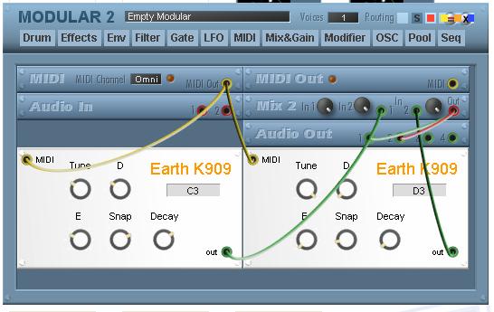

hey guys this is a new creation Enjoy !!]\
this is a moudular moudule just midi and out

- earth909k.JPG (38.28 KiB) Viewed 9303 times

ITs a really good start, but you need to make the modules standard size, or scope can crash when placing them if you are not careful
use multiple drums without using DVC, then you can still have a frequency range

hi earth.
nice module!
can I make some tips/suggestions?
your module is 249x135. this is not a size the Modular panel is made for. (as Neutron already mentioned.)
-standard Modular module width: 250 (extra broad modules can also have 500, 750...)
-Modular module height: multiples of 30 (30, 60, 90...) please? pretty please?
-text objects: please always uncheck "selectable"in GoTree
-presets: settings of your module are not saved in presets. it's darn easy:
--select Module
--click Window-Parameter-Parameters
---in the Parameters window, click Freeze
---in the Parameters window/Tree right-click, "init tree"
---select a control, eg envelope decay pot
---drag the "Val" parameter to the Parameters List
---repeat this for each control
nice module!
--select Module

1) i know i improved this and build a new one with standard size and made it removble :::::
the one you see on nuetrone was an original download .. you wodn;t get it

Just to be curious,
in what dev environment did you create the modular module?
Cheers,
Casper
Cheers,
Casper

Casper
the SDK ,,, 4.5 and with a lot of zero coca cola :::::::: 2012
Ya riba andele andele andele !!

earth wrote:Casper
Ah I see. Just thought I missed something...
Thanks!
Casper
