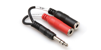

no, the Luna uses a stereo plug which is tip/ring/sleeve. one channel on the tip and the other on the ring. a y cable like this one
will give you two inputs. you can use analog source left as one and analog source right as a second mono channel.

Ok guys thx ! That sounds very doable to me. But wouldn't I have 2 L and R signals at this point,that i cannot PAN ? Because in the first days,when i was using a normal stereo jack with luna,i had exactly this problem....the guitar was on the LEFT and there was NO WAY of putting it in the middle :D you know what i mean ? So should i find an Y cable,but BALANCED ?
Thanks again for your precious help.The guitar is a yamaha acoustic /electrified which sound fine without any other preamp.
Re: connecting an external mixer to Luna2
analog source left goes to a MONO track. pan it any way you want.
analog source right goes to a MONO track. ditto.
