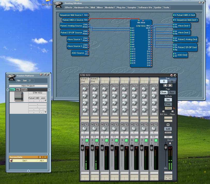

see the pic attached - loud static noiz taking place when the Pulsar 2 Analogue Source us attached to the STM mixer.
Cable whip is not even attached so its unrelated to that
the pci contacts should be clean as its a new mobo, right? i also changed between pci slots and that didnt help.
additional thoughts?

Re: Distorted sound/noises in mixer - Pulsar unworkable :(
same for me this august: it was improvvise IRQ conflict with other PCI devices (and USB chipsets) and heat.
solved removing one PCI board and putting (case pimp!) a 20cm fan in front of scoper+UAD boards.
how can anything come from the analog source if the whip isn't attached?
Because the card is broken
really?
even more to the point, why even connect the analog source to anything without a cable whip? if the noise comes from the analog source, but there's nothing connected to the analog source, nor can there even be, because there's no whip, the obvious and easy solution is to remove the analog source, since there's nothing that it's useful for.
