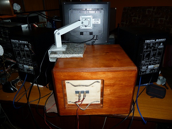

Just had a look at this unusual project... it's called 'the door'...

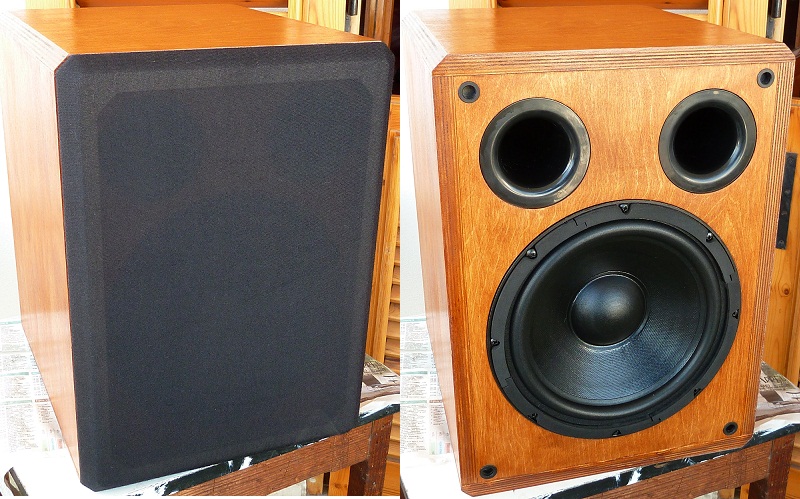

I've forgotten... this is the subwoofer
I didn't get the dedicated amp yet, so no hardware phase nor freq controls...

wow, that's massive :-)

I eventually succeeded in fitting the sub on the desk
I'm testing with external amp.
The sound is really deeper now (I'm filtering around 50 Hz)
One thing I didn't expect is the electrical signal at the sub speaker being almost 180 out of phase with the signal microphoned at B2031 woofer (50-60Hz measurements); the signals instead are almost phase aligned when I put the stock Scope low pass filter in the output chain to the subwoofer.
I'm wondering if I'm messing with bass reflex polarities and/or mic positioning

If that LCD is ccfl backlit the current mounting (to a vibrating subwoofer) is going to severely shorten its lifespan. Thought I'd warn you so you can prevent turning it on someday only to find it dark.

Thx for the info. I might try to put some damping material (a diver wet suit?) under the marble block where the arm is fixed... though those frequencies are hard to damp.
Then other troubles could happen with the other LCD staying in front of the subwoofer, under the visible one...

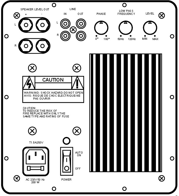

Is it completely 180 degrees out of phase? Many subs have a rotational control (rather than a switch) that helps you vary the phase...

The project provide this module
Now I should prefer a lower cutoff, staying to what I hear, leaving the B2031 unfiltered.

that's why the amp has a control for phase, so you can move it across the room if you have to.

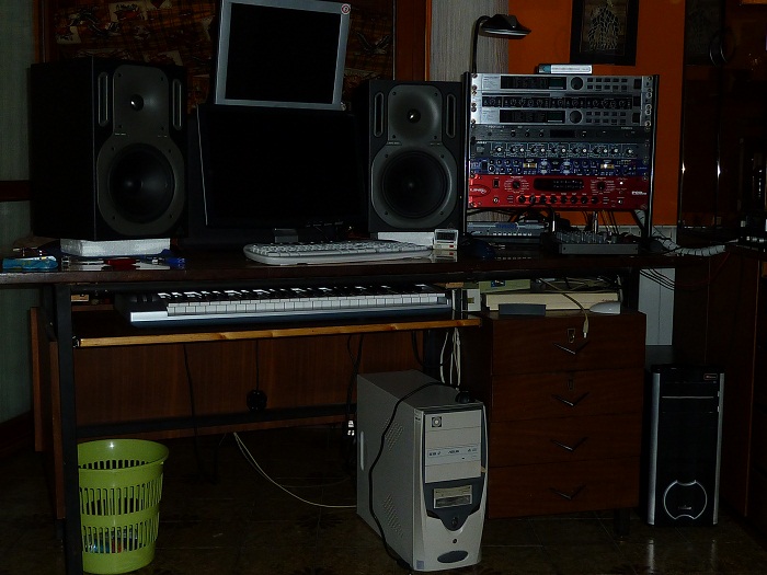

Cochise
Posts: 1305
Re: bass frequencies
Post by Cochise »
As you disclosed earlier, I've got peaks/valleys in the freq response if the volume ain't set at low levels; too low for effective EQing/mixing.

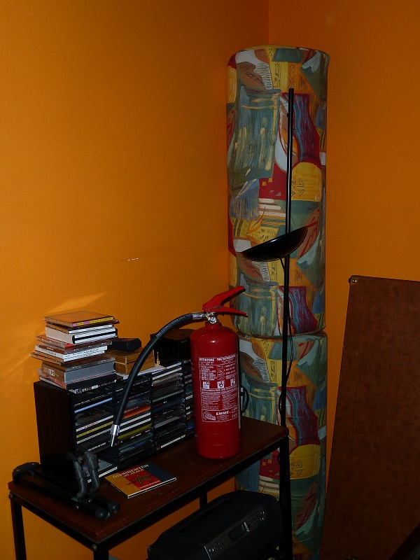

I had a look at the link kindly posted by Mehdi and, beside the wall panels, corner blocks acting as basstraps are available.
At now I'm just wondering untill which point the material is fireproof.
At now things look this way (not all the corners, though)
