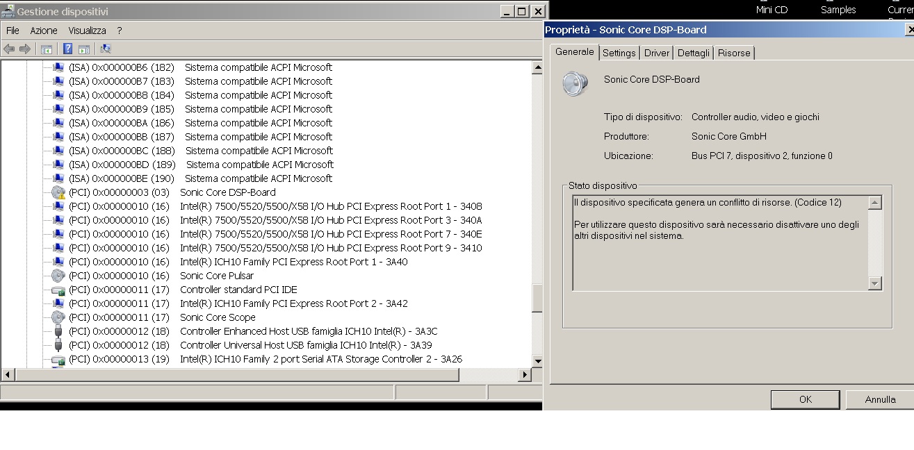

Re: failure with gigabyte X58 UD4
this is the situation.
the system is OK with the luna card out. so now i have 2 scope cards (pulsar1+scope).
SFP 5.1, win 7 64 bit and sonar 8.5.3 are up and running
just for the sake of doing it, i tried again to reinsert the third card but the situation didnt change.
in the attach there is an image of the error i get
the translation from italian is, more or less:
the board generate a conflict in the resources - error 12.
in order to use this device you must deactivate one of the other system devices.
as you can see, the board do not share irqs with any other device.
i have disabled everything not needed: usb, ieee controllers, etc...
the other two boards share irqs but work well.
i have a Club 3D HD3450 Noiseless Edition video card i have mounted on a pci e x4 slot (moving to a 16x slot do not change the siutuation)
the specific problem is with the last PCI slot of the gigabyte ud4 x58, the one near the PCB border.
any CW card inserted in that slot will not work.
in the bios there are no way to assign irq or to change the situation.
- Immagine.jpg (263.36 KiB) Viewed 4810 times
well, you can disable the pci-e root ports that you are not using in the device manager.
that's a problem with the design of that motherboard. not all motherboards are designed the same. did you check for a newer bios?
i willl try to disable that pci e root. is that safe?
yes, the bios is updated
yes, it's safe, but if you disable a root port that is assigned to a pci-e slot you are using(like video) that slot will stop working. as long as you don't disable the video slot, you should be ok. even if you disable something you are using, you should be able to turn it back on.
For the pci bandwith, even if it is sort of irrelevant, use an empty project (no mixer etc) and fill it up with regular masterverbs until you get the error message.bosone wrote: Now, a last question...
with win 7 already installed, if in the future i will decide to change just the MoBo (with maybe the asrock x58), will i have to reinstall all win 7 from scratch??? what about the activation??
As for the motherboard, i recently had to change one in my pc, including CPU and gfx card. i went from an nvidia chipset to intel chipset, and from an e6600 to a q6600 cpu. I didnt have to install anything, i just reconnected the cables and booted win7 as normal. worked fine, i just had to reactivate windows online since it noticed my Hardware changes.
