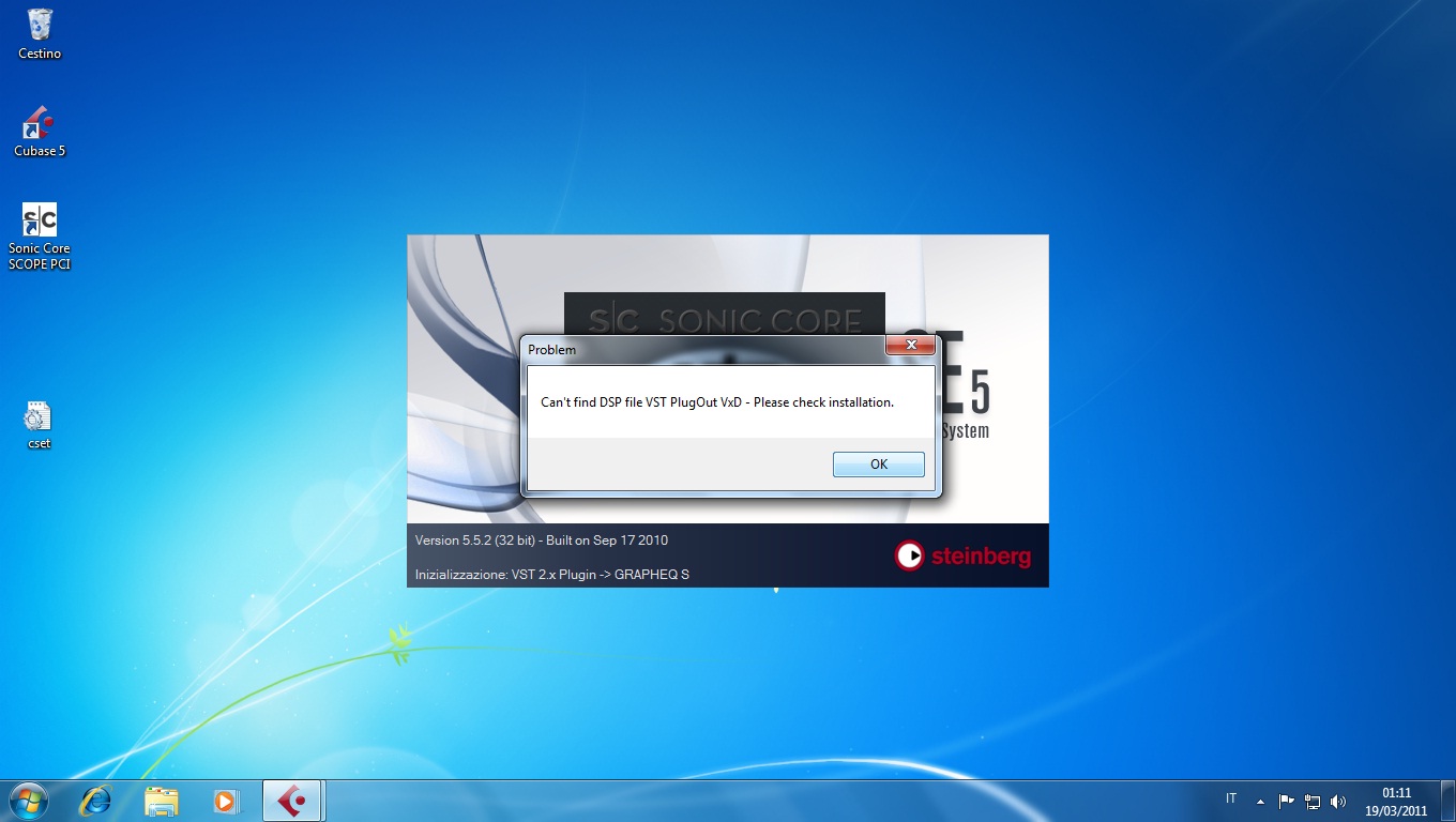

ok i have downgraded to 32 bit and now all vst connection are ok but why this:

:D ...... run as administrator :D :D
solved
