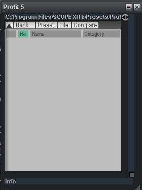

I have an auto-indexing problem with the Profit 5.
I use presets in this manner.........
Banks........use a " minus " like -Live 01.
In this way I retain all of the other Banks and presets in the same location, and the Bank I choose to perform with is instantly accesible vis MIDI CC Program change messages.
I then name the presets like MIDI CC Program changes where the number comes first.
I.E. 000 Brass, then 001 Clavinet, etc.etc.
Profit 5 seems to have a problem auto indexing.
Could you verify this for me...?
Make 3 presets, then add the numbers before their names and right click for auto indexing.
I get 003 then 001, 000, etc..............aaarrrggghhh....***
Ankyu........
I am RC2708 x64 but this could have been a problem in x86 Scope 5.0 carried over.
I will contact Holger or Ralf for a quick fix hopefully once verified.
It seems this is an slight oversight, and since folks here record its no big deal.
But I would like to use this live as the MIDI button for Filter sweeps is really convenient and the sound is pretty thick for a fake synth.

Not confirm it. autoindexing works fine. may be you need to click on "name" before indexing...?
- profit5.gif (172.72 KiB) Viewed 2261 times
