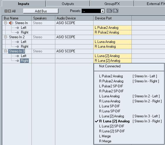

Hello everyone, I have the following problem with cubase 5.5.1 and asio scope in XTC mode
My system is based on 1 Luna + 2 pulsar 1 cards scope 4
On my previous system based on Pentium 4 2.6 ghz and 1 Gb of ram and win xp home sp3 with scope 4 I never had any problems.
My new system is a dual core E7400 2.8 ghz 4 GB of RAM and motherboard asrock with the same configuration (the 3 cards and win xp home sp3).
When I select the inputs and outputs of Luna card from vst connection system crashes causing an error in asioscop.dll
Ok, from the scope routing windows I delete the connection between the Luna inputs and the mixer and i save the project as default.
Now I can select the output Luna card from vst connection without a crash but if i select also input Luna card it goes back to crash

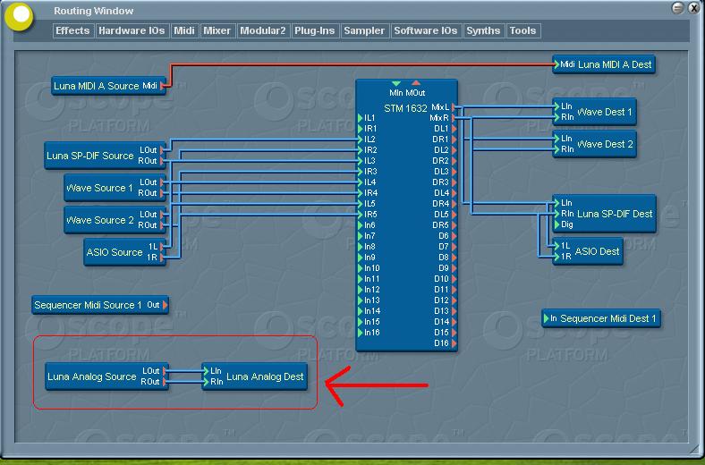

hi, i have solved :-)
I remember once I had the same problem that i had solved as in image:
